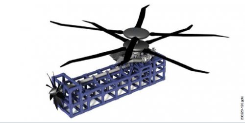

Sikorsky/Boeing SB-1 Defiant propulsion system test bed.
Artist's impression of Sikorsky/Boeing SB-1 Defiant.
http://events.aviationweek.com/html/ad13/Nov%2014_1100_Shidler%20Donnelly.pdf
