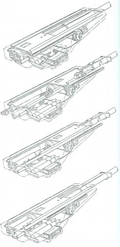

There was also an automatic loading M40A1 turret developed for vehicle use. Source is Hunnicutt, I think.

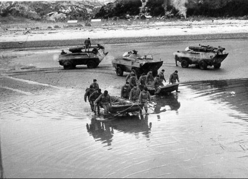

There was an (semi?)automatic rocket launcher developed in the 1950s or 1960s in Switzerland, if I am not mistaken, by Oerlikon. It was proposed as an armament option for numerous AFVs of that time, mostly wheeled. As I've just found out, it was actually adopted by the Chilean army mounted on their MOWAG armoured cars (see attached pics).
Do you know more on the launcher (its principles of operation and so on)? Any information, esp. pictures, would be appreciated.
Piotr

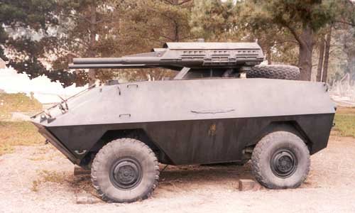

I have a poor-quality photocopy of a catalogue of the Oerlikon-Contraves weapon museum, which includes two entries on magazine-fed rocket launchers:
5 cm Raketen-Automat Oerlikon Typ 501 RA: a 50-rocket magazine, fired at 700 rpm. Developed 1954, intended for aircraft.
8 cm Zwillings-Raketenautomat Oerlikon Typ 3Z 8DLa: a twin launcher dating from 1964, intended for ships and AFVs. 9 rockets in each of two magazines, firing at 260-300 rpm combined.
(at least, that's a quick and dirty reading using my very sketchy knowledge of German!)

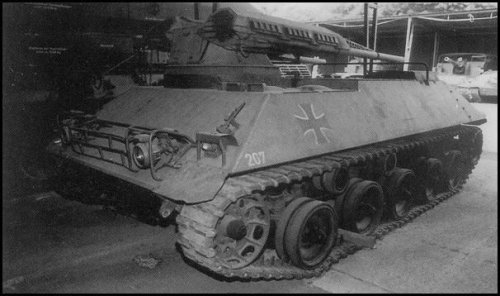

Re: Oerlikon (?) automatic rocket launcher
Piotr

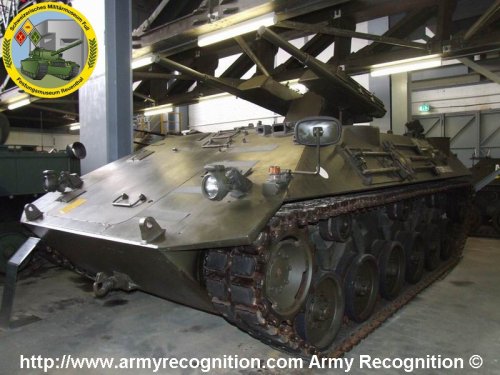

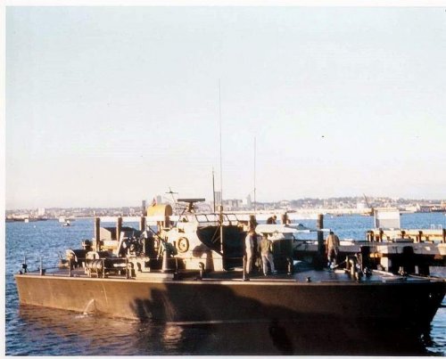

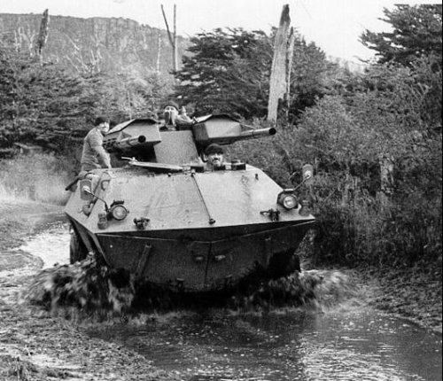

The launcher was also fitted to the Saurer/Steyr 4K3FA, the MOWAG Grenadier, Puma and Tornado, the HS30 and even the Nasty class PTF-13, among others.
Yep, those photos make it clear that this was the 8 cm Zwillings-Raketenautomat Oerlikon Typ 3Z 8DLa. Actual calibre was 81mm. Elevation limits were -10 to +50 degrees.
Thank you very much for information on the Oerlikon automatic launcher.
Having known its designation I found this: http://up.picr.de/5672636.pdf
Very interesting weapons system. Naturally it was being tested on many chassis (the Swedish Unimog-Landsverk armoured car was amongst them), but seemingly was used operationally only by the Chilean naval infantry. They deployed the rocket armed MOWAG Grenadiers during 'the war that never was', i.e. the Beagle canal conflict with Argentina in 1978/79.

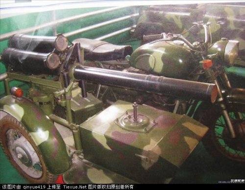

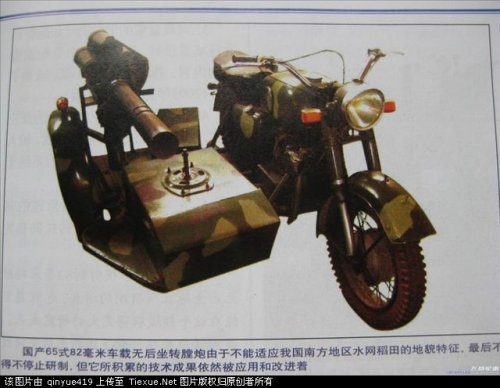

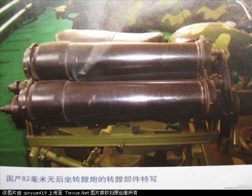

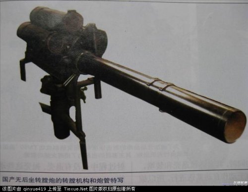

I'm not entirely sure if this is a revolver system or if the reloads are carried over the tube, but certainly looks like the former.
Made in China with an 82mm weapon.

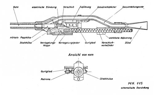

poky said:
the Germans tested a 55mm recoilless gun during WW2, the MK115
Below (next to right-hand one) is my replica of the ammunition developed for the gun, from the Ammo Photo Gallery on my website. The beige part of the case represents the combustible element.

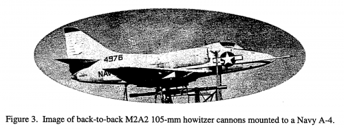

Oerlikon automatic rocket launcher it is a rocket launcher that fires 81 mm rockets it does not use the principle of recoiless gun.
only the Germans managed to make recoiless gun that fired 55mm ammunition

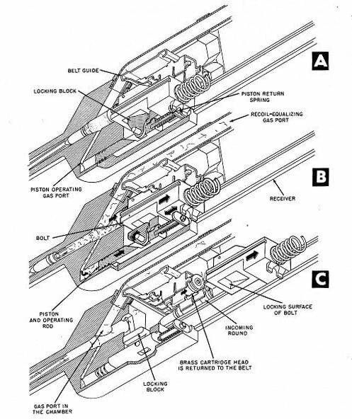

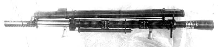

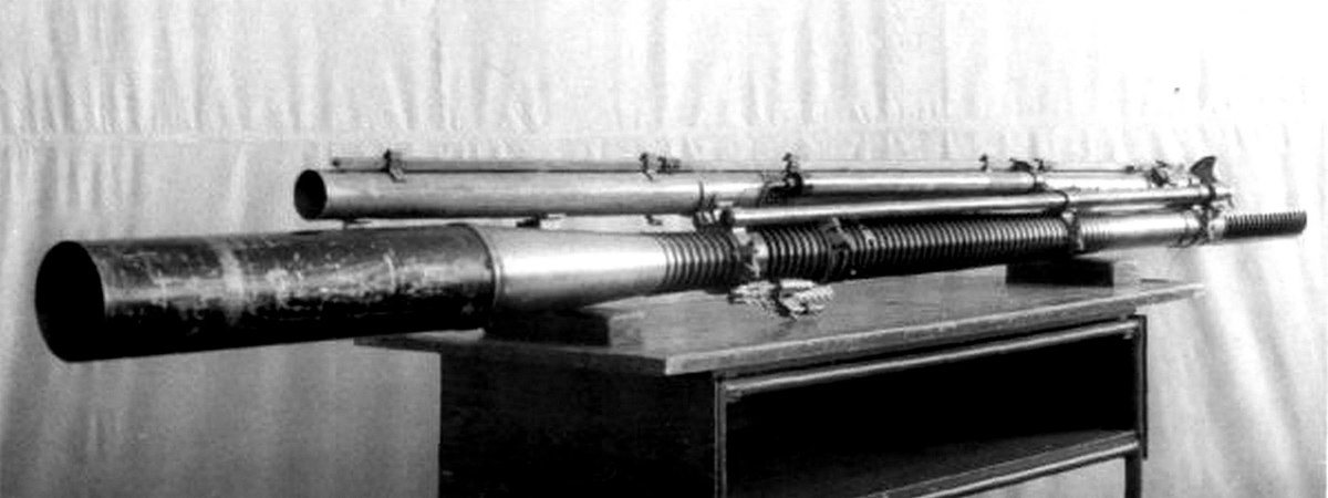

The Soviet designer Leonid Kurchevsky was the first to make a recoilless weapon that fires grenades automatically. He used a gas cylinder which was connected to a piston which in turn opened the cannon door and then closed it.
Leonid Kurchevski a picture of the appearance of the cannon with the the air piston to move the gun breech
