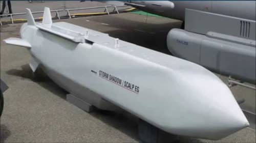

Perhaps but the fact still remains that the range claimed was 1.7x less than the TLAM-E and probably even more less than the Block Vb. So even with a lot less efficiency, the range is still plausible, especially with a air-launch. Even the early Tomahawks used in the Gulf War were 1300km range too. I would also argue that the internal volume of a Storm Shadow for storing fuel is probably slightly larger if anything.A lifting fuselage equates to a very low aspect ratio wing, hence extremely poor induced drag for the lift it contributes. We are not talking about a regime where you are happy to take ANY lift you can get (e.g. low speed, high-AoA turn in a fighter: vortex lift). In cruise, it will always be preferable to fulfill all of the lift requirement from an efficient high-aspect ratio wing and minimize the drag contribution of the rest of the airframe by keeping wetted area down.
