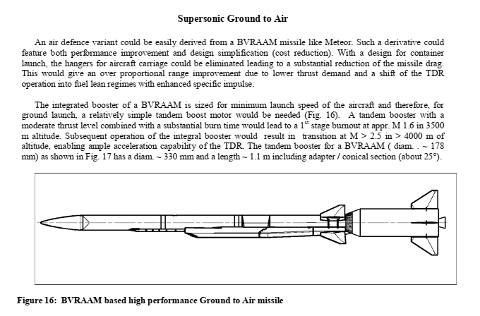

This is from "FIT FOR MISSION – DESIGN TAILORING ASPECTS OF THROTTLEABLE DUCTED ROCKET PROPULSION SYSTEMS"
Apparently there is indeed SAM version of Meteor being considered. However it never really get off the conceptual stage.
