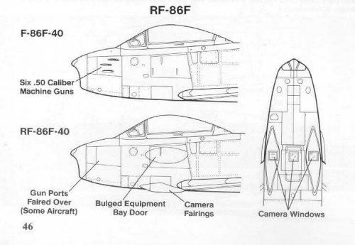

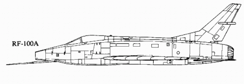

3.Does anyone have any type of side view drawing or profile of the RF-100A or RF-86F?
From Angelucci/Bowers a side view of the RF-100A and from Squadron Signal N°126
drawings of the RF-86A and RF-86F. The RF-86A are said to be more or less a stop-gap,
replaced later by modified F-86F, not all of them retained 2 0.5in guns.
