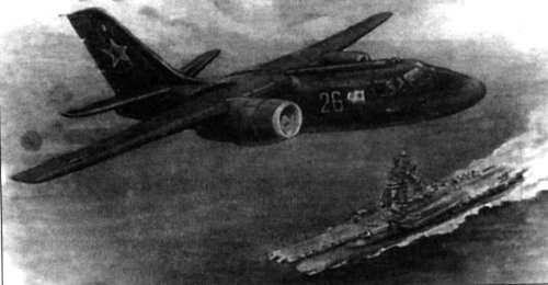

Su-27K "Buran" and P-42
Thank you for the pictures of the Su-27K by 1972. You can specify the source? There are similar pictures of the Su-28K and Su-29K?

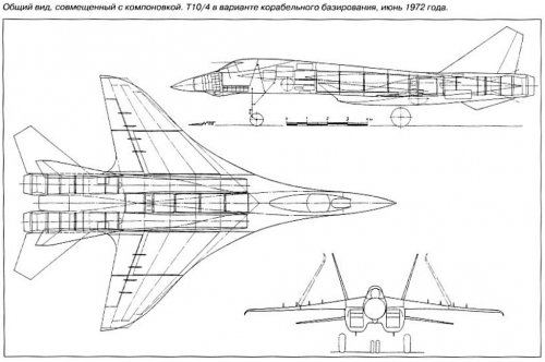

mechan said:
1. Thank you for the pictures of the Su-27K by 1972. You can specify the source?
2. There are similar pictures of the Su-28K and Su-29K?

The underwing missile looks to me like a badly drawn K-25, while the underfuselage missile looks like a Martel analogue- a TV guided AShM.

1. Photo of the project of the Su-27K "Buran" deck aircraft. Sukhoi Design Bureau
2. Photo project of the T-10/4 deck aircraft. This is a modification of the T-10 (Su-27) project. Sukhoi
Design Bureau
3 . Photo of the project of the Beriev Design Bureau's P-42 deck anti-submarine aircraft.
