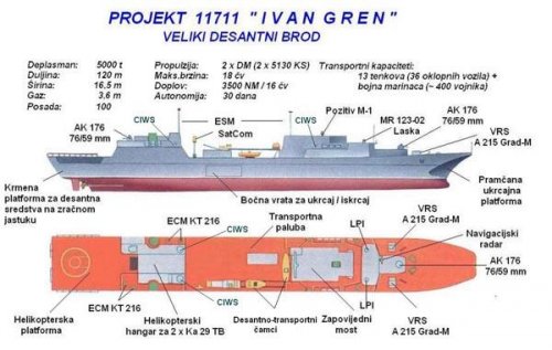

According to the conceptual design, the basic specifications of the large landing ship of Project 11711E are the following:
image.aspx
Displacement, full-load, t about 5,000
Length, m 120
Breadth, m 16.5
Mean draught, m 3.6
Propulsion plant diesel (10D49)
Main engines (number x power), hp 2 x 5,000
Full speed, knots 18
Endurance, days 30
Crushing range at 16 knots, miles 3,500
Complement, men about 100
Armament
Multiple launch rocket system:
Number of systems 2
Caliber,140 mm
Self-defense weapons:
Number and type of artillery gun mounts
(barrels x caliber) 1 AK-176
(1 x 76mm), 2 AK-630 (6 x 30mm)
Helicopter:
Helicopter Ka-29,
landing spot, hangar
Landing control system Modul-V
Military lift 13 60-ton tanks or 36 APCs;
300 troops

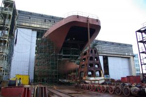

Photo: Bow part of large landing ship Ivan Gren. navalshow.ru
Yantar Shipyard (Kaliningrad) plans to deliver Project 11711 large landing ship Ivan Gren to Russian Navy in 2012, reports press service of JSC Armalit-1 which produces pipeline accessories for the ship. As for now, 89 per cent items have been already supplied in accordance with the contract, says the press release. The ship's completion will last throughout 2011.

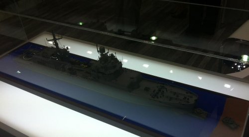

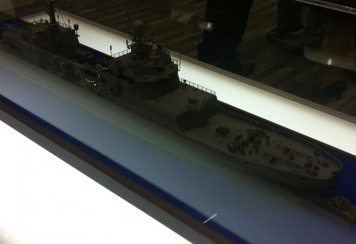

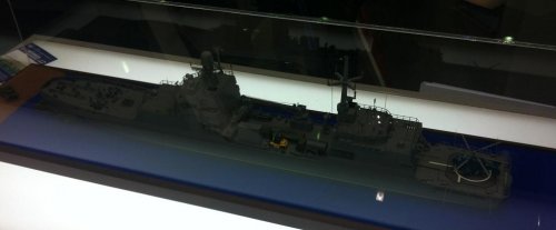

Model of Project 11711E on display at Euronaval 2014.
Via Google Translate:
Model large landing ship project 11711E development of "Neva Design Bureau" in the joint exposition of JSC "United Shipbuilding Corporation" exhibition Euronaval 2014. As can be seen, the present model actually shows look to finish building the ship "Ivan Gren" project 11711 in the "final configuration". The armament of the ship, according to this model and handout consists of one 30-mm artillery installation AK-630M-2 "Duet" and two 30-mm gun mounts AK-630M-06. Le Bourget, 27/10/2014 (c) bmpd

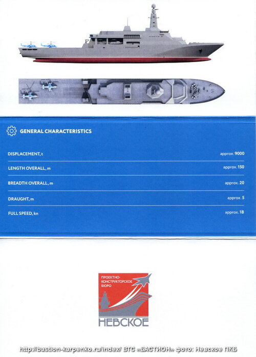

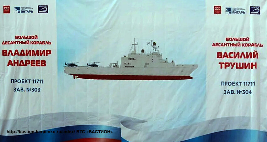

According to the results of tests and initial operation, the Russian Navy is satisfied with the technical solutions implemented in the ship of Project 11711. Accordingly, the Ministry of Defence decided to build another pair of such ships. "Vladimir Andreev" and "Vasily Trushin" laid at the Yantar Shipyard in the spring of this year. At the same time, the customer made a number of comments and suggestions. Based on them, a decision was made to improve the operational characteristics of Project 11711 ships. So, the aft superstructure moved forward, which, together with other measures, allowed the designers to increase the size of the hangar and helipad. The composition of the air group grew to four Ka-27s. This is a significant increase, against the background of the fact that the large landing ships of past generations did not have permanent helicopters at all, and could only temporarily take one machine to the upper deck section.

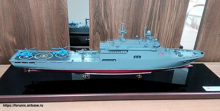

The greatest length increased by thirty meters, up to 150, width (on design waterline) - by two meters, up to 19.5, displacement - by two thousand tons (standard 7000, total 8000 tons). The possibility of using the ship and unmanned aerial vehicle is claimed. The ship will additionally receive a 76-mm artillery mount and an integrated electronic warfare subsystem. At the same time, the remaining technical solutions were preserved, so it was decided to keep the project number. For the first time, a large-scale model of the ship of the adjusted project (11711E) was publicly presented at IMDS’2019.
The model is likely to be built for the Russian Navy:

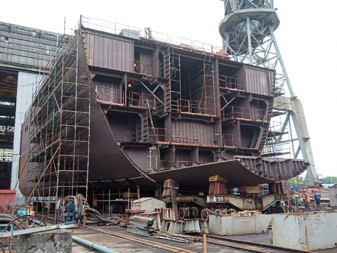

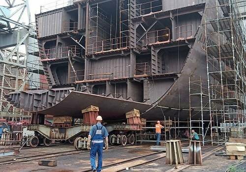

It appears the first hull sub-section has just been rolled out of the enlarged, follow on 11711E, Vladimir Andreev.
Surprisingly, there are no guns. As well as the Pantsir-ME complex.
Although I think they will appear there.
