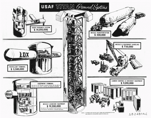

I found this photograph in the Archives II Photographic floor which illustrates the cost of a single liquid fuelled ICBM silo. See attached photo. Now multiply that by what five missiles to achieve a 90% pK against a VN-12 target (I'm assuming bigger warhead on Titan means less missiles are needed than the Minuteman example.)
Do you have the link to the FY64 to FY68 Retaliatory Forces Memo or did I miss it somewhere above?
No, but I can upload it. I don't think I ever OCRed it fully.
EDIT: Actrually I did.
I just have so much stuff I keep losing track of what I have or have not done. :D
Link to 64-68
