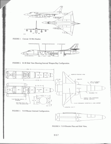

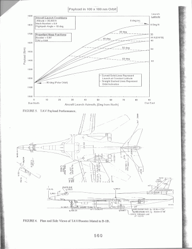

Orionblamblam
ACCESS: Above Top Secret
Apr 5, 2006
8,111
1,628
antigravite said:
Do you have any date -- rather year -- for this concept? Was it 1995?
If you follow the link back...
An air launched, highly responsive military transatmospheric vehicle (TAV), based on existing aerospace systems
AIP Conf. Proc. -- March 1, 1996 -- Volume 361, pp. 555-564
Space technology and applications international forum: 1st conference on commercial development of space; 1st conference on next generation launch systems; 2nd spacecraft thermal control symposium; 13th symposium on space nuclear power and propulsion; DOI:10.1063/1.49958
Issue Date: 1 March 1996
