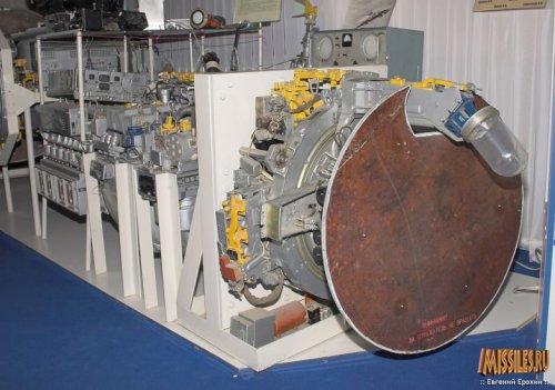

Phazotron Sapfir-23 and Sapfir-25 radar
Sapfir-23E Radar
This post is by mrdetonator, at the acig.org forums, hopefully he will be here soon to repost himself.
The Sapfir-23E (izdelie 323E).

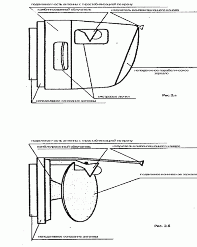

The S-23E radar contains of 46 parts weighting total 641kg. Main parts:
The two-mirror cassegrain antenna: 78kg

Sapfir-23 (Izdeliye 323)
From Phazotron museum, missiles.ru.
Nope, this is not a 323, this should be a Sapfir-23MLx Radar. The Sapfir-23DIII (item 323) or Sapfir-23E (323E) has the transmitter/receiver centered.
BTW, the yellow wave guide on top is part of the, so called, "compensation channel". Introduced with the RP-22 radar (MiG-21 variants and MiG-23MS) it was one step to reduced the minimal operational altitude from 1500m to 1000m (because of ground clutter). It was also used with the Sapfir-23. Normally extend above the fixed part of the radar antenna, except the Sapfir-23DIII and Sapfir-23E. There it is directed to the moveable part of the antenna. You can see it on the first picture of mrdetonator's description about the Sapfir-23E.
This channel was activated only in "SMV" radar mode (scan lines above horizont Hs < 1.5km).
overscan said:
Yes, you are correct.
Phazotron museum labelling sucks, apparently.
The picture doesn`t show the Sapfir-23MLx either. According to manuals both radars the 323E and the N-003 share the same design where the trasmitter/receiver waveguide is placed in the middle of the antenna.
crossiathh said:
BTW, the yellow wave guide on top is part of the, so called, "compensation channel"... Normally extend above the fixed part of the radar antenna, except the Sapfir-23DIII and Sapfir-23E. There it is directed to the moveable part of the antenna.
Got some new information. While with the rp-22 and the sapfir-23MLx the "compensation channel" is a receiver the Sapfir-23DIII/E has a transmitter with two emitter directed to the moveable reflector of the antenna.
@mrdetonator: Could you please double-check this.
After browsing through my archive I found a photo clearly showing this type of antenna mounted on czechoslovak Mig-23ML(variant A). Gentlemen, I give up..... :-[ :-[
Don't worry Martin- its enough to drive anyone mad!
I think on this occasion you were mistaken- that or the manual was wrong!
The Sapfir-23E uses the mono-pulse technique to track a single target.[
If on picture Sapfir-23 in the description it is written that it has the latent conic scanning
@Vadifon
Could you please provide the picture with higher resolution which would makes it possible to read the descriptions?! Thanks.
