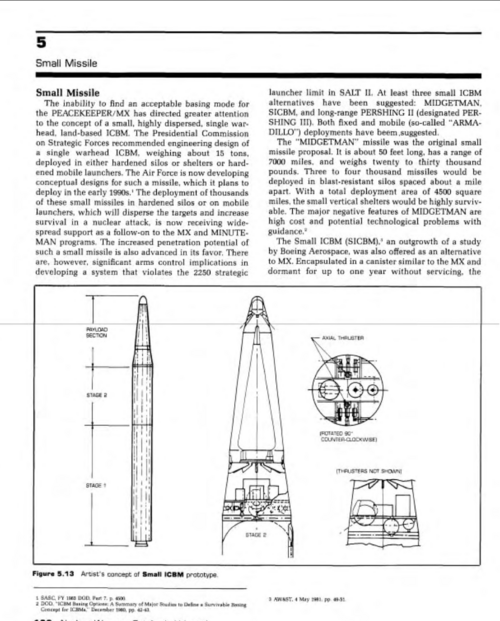

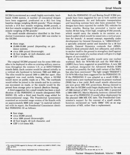

Great paper on the Pershing. I read in "Nuclear Weapons Databook" a "big" Pershing as an SICBM alternative any information on that program?
That's a new one to me. I'll have to keep looking.
XP67_Moonbat said:
That's a new one to me. I'll have to kepp looking.
Look on pages 132 and 133 of Nuclear Weapons Databook Volume I US Nuclear Forces and Capabilities several mentions of an SICBM alternative called the Pershing III.
Boy back in the day when you used to get Time and Newsweek cover stories with pictures of MX's and SICBM and Trident missile launches. Oh the "good ole days" ;)
As per the "Bulletin of the Atomic Scientists", July 1983 (page 13):
"Another Pershing missile variant, a four-stage, 25,000-pound strategic missile designated Pershing III is being proposed by Martin Marietta as a contender for the small ICBM which is proposed as an eventual replacement for the MX missile."
I also found a 1981 reference to the Pershing III designation in the Flight online archive, but that was a hypothetical three-stage sub-strategic version with no indication that it actually existed as a real project.

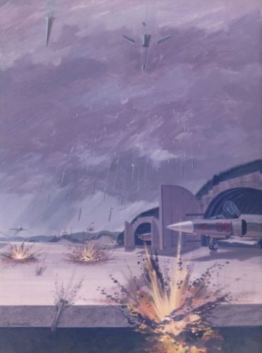

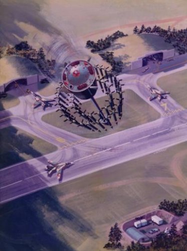

Another member of the Pershing family that it would be nice to know more about is the Conventional Airfield Attack Missile / Counter Air Missile / CAM-40
c. Conventional Airfield Attack Missile (CAAM)
The combination of the Warsaw Pact Air Force numerical
superiority, coupled with their opportunity to initiate an attack
against NATO airbases and other high-value targets continues to be a
difficult problem. Our efforts to counter the Pact advantage have
included aircraft sheltering, ground and air defenses, and a conventional
second-strike capability utilizing attack aircraft. The
interdiction of Pact main operating air bases (MOBs) to reduce their
aircraft sortie rate potential is difficult because of the combination
of airbase hardening, air defenses and weather. Technology now will
permit effective, immediate and virtually unstoppable counter attacks
with conventionally armed surface-to-surface missiles, regardless of
weather or defenses in the target area. Cost and operational
effectiveness analyses conducted during the past year have verified
that such a system would have a relatively high payoff for an initial
attack supported by follow-up aircraft attacks. A conceptual design
and feasibility demonstration activity for a PERSHING II version of a
Conventional Airfield Attack Missile (CAAM) was initiated last year.
We are requesting $5.0 million in FY 1979 to continue this feasibility
demonstration activity.
THE FY 1979 DEPARTMENT OF DEFENSE PROGRAM FOR RESEARCH, DEVELOPMENT, AND ACQUISITION
(Images via link in first post of the Assault Breaker thread [h/t sferrin])
Original Caption: Counter Air Missile. Terminal phase of a CAM strike, the delivery vehicle spins up and dispenses its payload of penetrators, each of which will find its way through a runway or taxiway surface. CAM uses a Pershing airframe, including the radar area correlator for terminal guidance. CAM is not yet funded and one major drawback to the system is that a wave of CAM configured Pershings approaching Warpac air bases could well be mistaken for nuclear armed Pershings with resulting horrendous consequences.

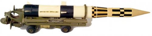

If you like models, this site has some interesting ones of Pershings I and II

IIRC the SICBM reached prototype stage with a few successful test-launches before being cancelled due to the end of the Cold War.
Wasn’t Pershing III a different program (basically a PII with an extra stage) that never went beyond drawings?
Would it have still had a manoeuvring RV though? The CEP quotes 1-1.8x MX.
I imagine it would, having terminal homing capability with its' RADAG seeker would've enabled it to use a low yield TN warhead.
It's pretty ambitious given the size - 1.02m x 13m for 8,000 miles! The LGM-134 Midgetman was 1.17m x 14m and had a range of 6,800 miles.
Is the throw weight the warhead weight or entire RV? It says 1,000lbs for this thing, for Pershing II the all-up RV weight was ~1,500lbs according to wiki.
Some real clues in that drawing isayyo2 posted about how control fins would be stored prior to deployment on ICBM-level MaRVs.
