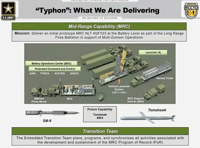

Seems like as good of place as any to put this. (It's probably elsewhere on this site but for the life of me don't know what it would be called.) This missile, second from right. Almost looks like it could be a Mk72 booster with a 21" sized second stage (think SM-6 Block IB) and a THAAD KKV. I wonder if the Navy is looking at something like this.

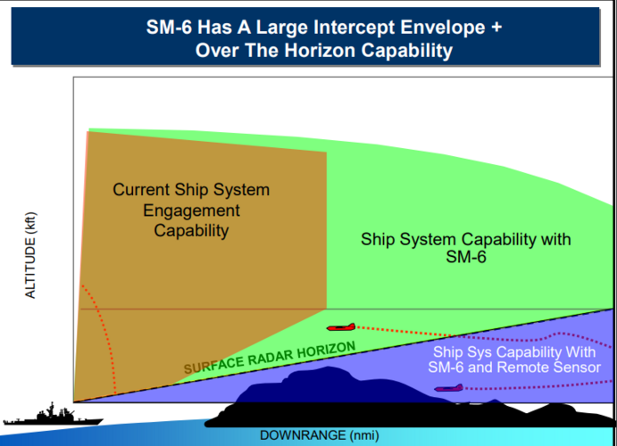

I spent couple of hours searching for this because I remembered I had seen an illustration of it somewhere before. The Navy did actually consider this long ago but it didn't win, according to JHU/APL, a "boosted THAAD" which is what is shown above was considered for the NTW but it lost out against SM LEAP.
Overland Cruise Missile Defense (OCMD) w/ more CEC sensors mentioned in the paper begs the question whether SM based/Mid Range Capability (MRC) or new missile shouldn't have been the basis for maximum commonality missile to engage ground Time Critical target (TCTs), cruise msles, and TBMs. Continuing to upgrade Patroit and even boost THAAD does not render the best overall encompassing capability. Engaging the TELs "pre-boost Phase" as it has been termed, is first priority w/ a capability against the missiles themselves second.
Looks like the Future Interceptor Program start got pushed a year right.
Thinking out loud, perhaps this is not such a bad thing given what all the Army currently has in the works. If Congress was interested in an expanded TBM and CMD battlespace for IAMD then one fairly low-risk solution would be to integrate the MRC launcher (MK41) into AIAMD and utilize the SM-61A and 1B interceptors. Given the Navy plans to use these for an initial counter hypersonic capability the Army could also benefit greatly from that. Given the pace at which the Army operates at a completely new clean sheet LTFI is a minimum 10-12 year project and Iran etc would have made significant strides in their ballistic missile program by then.

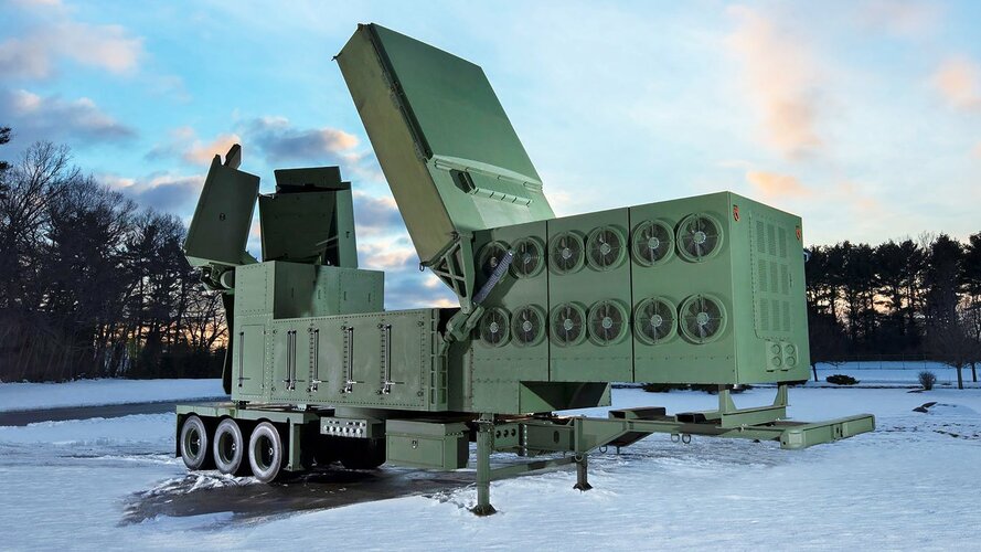

Defense News May 2, Raytheon has run into problems with its prototypes for the new radar for Patriot system, LTAMDS, Lower Tier Air and Missile Defense Sensor, a variant of the SPY-6, do wonder if the problems not sorted in danger of cancellation, my impression of the radar was an unwieldy beast for an easily transportable system.

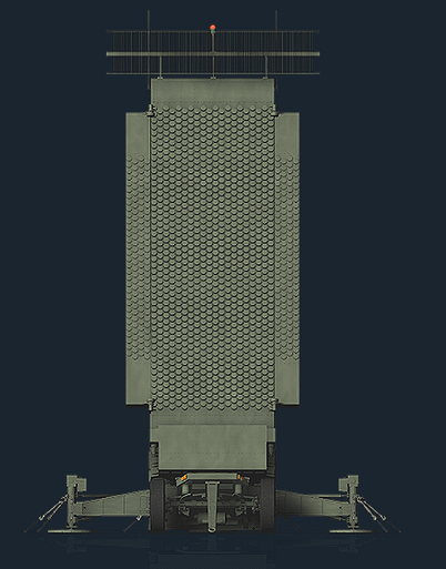

Pure speculation for possible alternative radars, the new Air Force TPY-4/3DELRR L-band available in both fixed and transportable variants small enough to be transported via C-130, truck, rail, or helicopter etc and the new Army A4 Sentinel X-band, which radars near similar in concept to the MEADS system radars, UHF 360 degree surveillance and X-band FCR.
https://www.defensenews.com/land/20...o-keep-its-new-air-defense-radar-on-schedule/

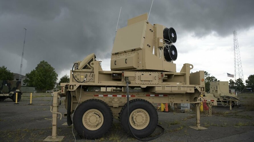

They're not having problems with the radar itself, at least not that have been reported to date, and TPY-4 is less mobile than LTAMDS. I think they're still having trouble getting the smaller "secondary" arrays, which give each trailer 360 degree coverage, integrated in a satisfactory way. I imagine the worst-case for this system is to delete those, or place them on a secondary trailer, and work around the problems that creates.
Thanks, understood Congress called for the new Patriot radar to give 360 degree coverage though Army didn't. The Sept 2019 Abqaiq–Khurais attack by Iranian drones on the Saudi refinery was successful even though defended by Skyguard, Shahine (Crotale) and Patriot, suggested the radars were pointing in wrong direction, would likely have been pointed south towards Yemen. In response Trump sent a battery of Patriot missile launchers, 200 troops and four A3 Sentinel X-band radars each giving 360 degree coverage.
Perhaps not understanding all the parameters but the TPY-4 looks much more mobile than the LTAMDS, a TPY-4 can fitted into a C-130 cargo hold, 10 ft wide and 9 ft high, think LTAMDS just too big and heavy.

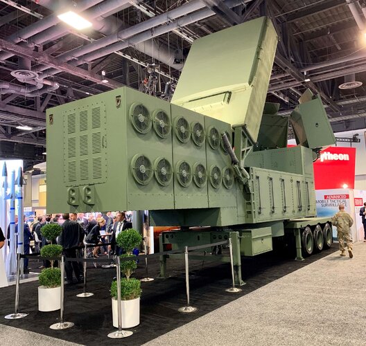

The new gen and more powerful LTAMDS radar looks large and heavy, reflected in the current Patriot generator 150kW whereas you mention the new radar requires a 500kW generator. If so the big downside will be the at the expense of the Patriot battery unit mobility, presuming the trade off accepted as it reflects the need to counter hypersonic missiles with increased radar range with its large fixed forward array?
The current radar is so underpowered that it limits the current missile (MSE's) envelope. LTAMDS not only expands the battlespace (360 degree) but also allows MSE to be used to its full potential (w/o a need to have. TPY-2 around) but also for future interceptors to be made capable of engaging TBM's at higher altitudes and greater keep out ranges. Even the much smaller MEADS X-band array was going to utilize a 300kW PD system. They are currently utilizing the PU-810 with initial LTAMDS and I don't think the LTPS will be any bigger than that footprint. It should not have a very significant impact on deployability or mobility once weighed against the advantages one gains in performance and threat engagement. IAMD also makes them a lot nimbler and effective given that now launchers, and radars can be tens of miles apart. Not to mention the ability to build composite units with IFPC launchers.

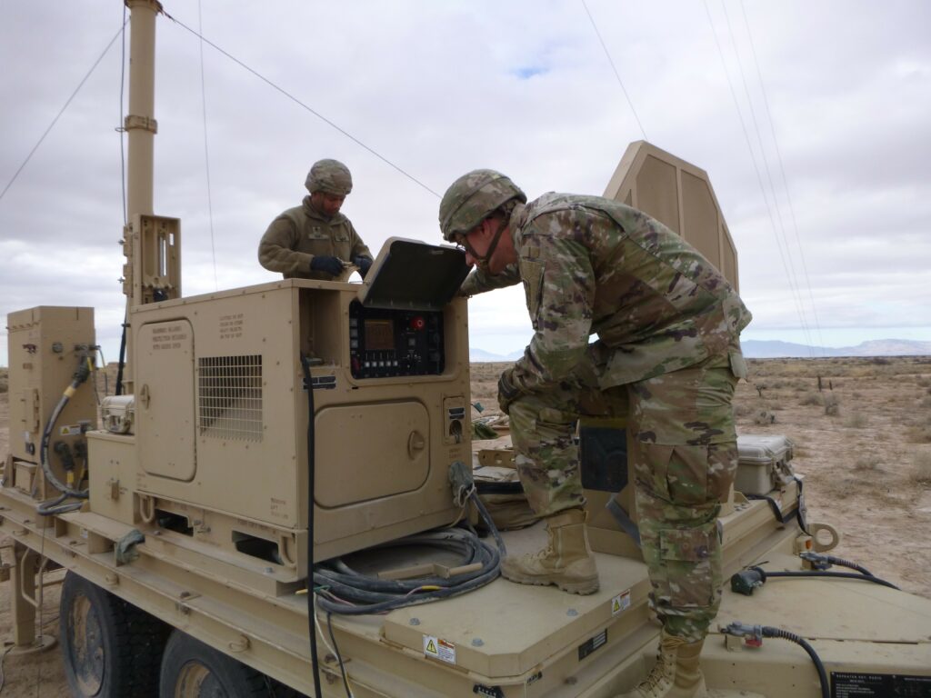

Thanks for ref on the PU-810 generator, global security
"The MEP PU 810 A is configured for low speed maneuverability only and can be transported aboard a C-130 aircraft. The MEP PU 810 B is configured with a "fifth wheel" and is DOT certified for highway travel, but cannot be transported aboard the C-130 aircraft"
Is it expected Army/Raytheon will be developing a new more deployable/mobile generator to power the LTAMDS. The Navy upgraded the Burkes Flt III's for Raytheon's larger SPY-6 by upgrading their three generators from 3MW to 4MW each and increasing the cooling capacity from 1000 refrigeration tons to ~1400-1500 t with ships five ac plants to cope with the additional heat output from its new radar etc.
The Army is currently funding prototypes from 2 vendors and will have a down-select soon and aims to have the new power system in production and fielded by FY-26. The PU810 is an interim solution until it is fielded. Not sure why the infatuation with C-130 (or with the Navy's destroyers). PATRIOT is not a C-130 deployable system though few individual elements may be. This is not a design driver so the Army doesn't pay the premium (in design and cost) for it. The future power supply solution will have two 500 kw, 480 volt generators mounted on a single M870A4 with the power system being C17/C5 transportable.
