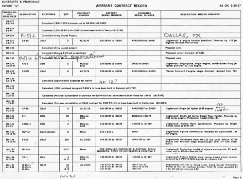

What was the block number for the cancelled P-51Hs 44-64718/-65159? -SP
BTW: NA-138 was for 629 cancelled P-51Ds - not P-51Es. See document. -SP

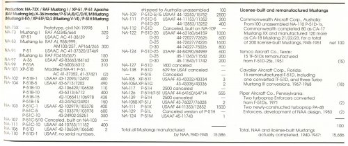

XB-70 Guy said:
Was was the block number for the cancelled P-51Hs 44-64718/-65159? -SP
I have only these serials and no information as to the constructor's numbers, although there probably were none allocated.
From Norm Avery's book.

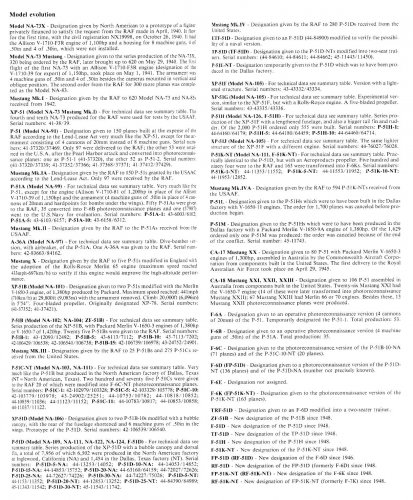

Found some more in "The American Fighter" by Enzo Angelucci and Peter M. Bowers:
