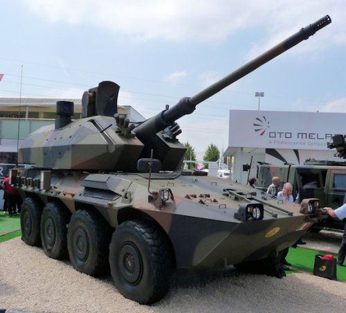

A heavily redesigned turret has reappeared in the past couple years intended specifically for C-RAM use on a Centauro armored car hull No takers so far, I can think of many reasons why but it wasn't a bad idea for a quick solution.
Next to the photo from my website you posted, there is this information about it:

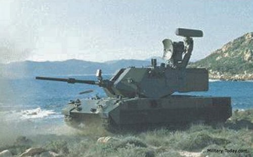

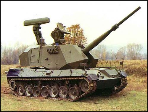

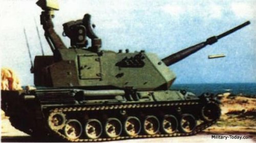

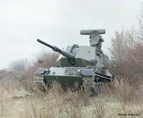

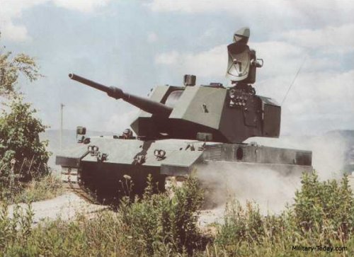

Here are some more pics of the Otomatic, both on OF-40 and Leopard 1 chassis.

If I recall correctly, the main reason behind this was the ability to hit helecopters outside the maximum range of their ATGW's.
Obviously once helicopter launched ATGW's ranges started to get around the 8 to 10 kilometer mark, it made the Otomatic less attractive over the vanilla 35mm guns usually used in this role.

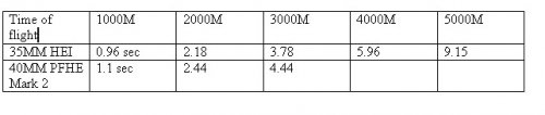

The guided HEFSDS shell also has a short time of flight(5 sec to 5km) compared to the 35mm Hei and the 40mm PFHE Mark2.

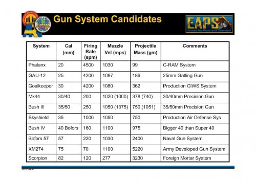

The C-RAM role is far more appealing because at that point cost issues are less relevant, the entire goalis to spend a small fortune to save people, and the much higher number of engagements before reloading makes shellfire much more favorable then any existing missile system could be. The ongoing US Army EAPS program actually considered that automatic 75mm gun developed for the RDF light tank, before settling on a twin 50mm as its gun solution, being designed alongside a very small radar guided missile which I believe was test fired not long ago. Main downside of the RDF 75mm was that while automatic, it was only about 40rpm and judged not worth the trouble of improving upon.
"Twin 50mm"?
Interesting. That's an unusual calibre for the US. Are these completely new guns and rounds?
No, 50mm supershot version of the Bushmaster III chaingun brought back from the dead.
It's a little more complicated than that. The 50x330 cartridge case from the Supershot is used, but the guided projectile is much longer, sticking so far out of the case that the cartridge can't fit into the Bushy III. The gun is accordingly a hybrid of parts from the Bushy III and IV (which was developed for 40x365 Bofors ammo).

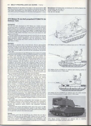

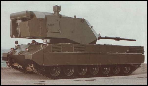

Here is an article on the OTOMATIC from US Armor magazine. Has some details on its design and opinion about possible use.
  • 76mm OTOmatic.pdf
Thank's CostasTT, I think this is the first time I've seen the Otomatic in it's travelling/storage configuration.

Wow, that's a huge turret for the OTOMATIC... Not sure I can see it viable today as an SPAAG, but stick one on the back of a truck or trailer as a CRAM? heck yes.
