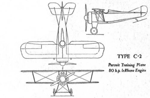

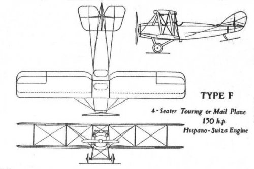

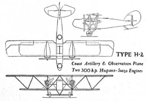

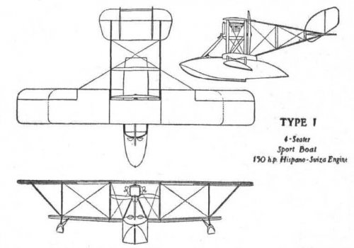

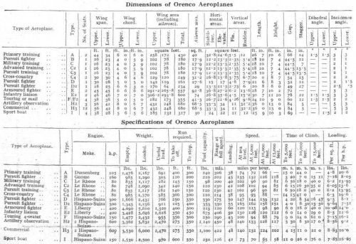

Found the attached in Flight of 1 April 1920. (flightglobal.com)

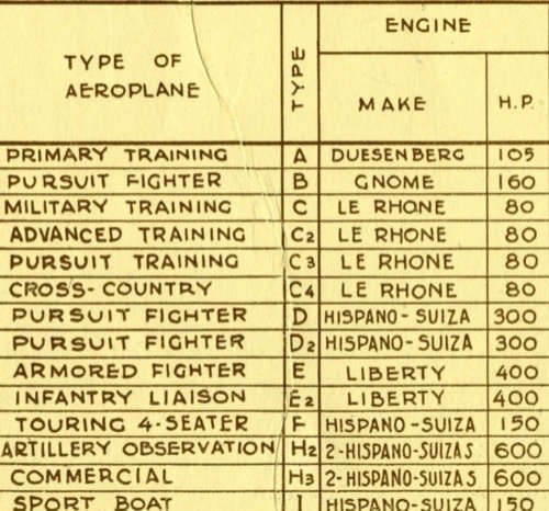

Some Ordnance Engineering Co (Orenco) projects are mentioned in the attached photocopy of an Orenco company catalog page.
Projects mentioned: H2 observation, E/E2 military biplane, H3 commercial and a twin-engine Bomber.
An issue of WWI Aero from 1990/1991 also had the page as part of an Orenco feature.
