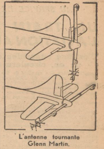

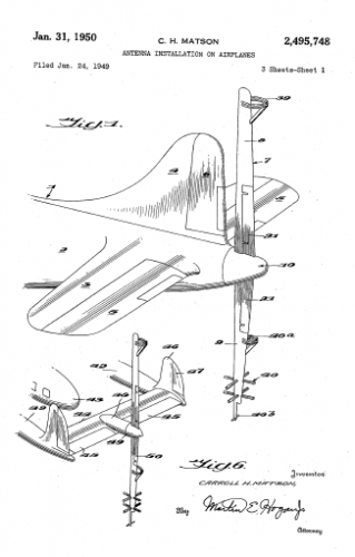

From Ailes 6/1950,
here is an a strange idea from Glenn Martin;
A ROTATING ANTENNA MAT was designed by the Glenn L. Martin Company for
be used either for issued
or retransmissions into
television relay, either for the
radio-guidance of remote-controlled machines.
This antenna can be mounted
on the stern cone and be
standing upright, during
the flights, for the issue, or, still, in intermediate positions between the vertical and
the horizontal. His presence at the
continued the elevators would have no effect on
the action of the latter during the
take off and climb the plane
This installation is the result
Martin's "stratovision" experiments
in collaboration with Westinghouse Electria Corporation:
these experiences showed everything
the interest that would present a mast
antenna as far away as possible from the mass of the wing
and, especially, powertrain groups, because the propellers of the latter absorb in part
emissions and cause
"Ghost signals". With the stern antenna, it would also avoid the distortions caused in the emission field by the main structures of the aircraft.
