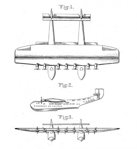

This is the beast from the patent....

The Patent does not feature the same wing shape as the article art. The explanation is a late variable geometry about the dihedral. Not yet in the Patent filed in 1937? I am just wondering about dates, as the Flight source seemed to mention 1952 (as based on 1951 statistics).
Can you quote patent number and date and ref to Flight article please?
Generally illustrations in patents, which are necessarily produced very early before anything else is published, are not designs to be built but pictures to make clear the patentable features. I'm interested to know what these might be. What, apart from sheer size, was novel about this plane in 1942? The twin hulls?
Twin-hulls patentable in 1942 (or even 1937) seem improbable to me.. ;) Everyone stayng in Chicago in 1933 would have seen plenty of twin-hulls flying around... ;D

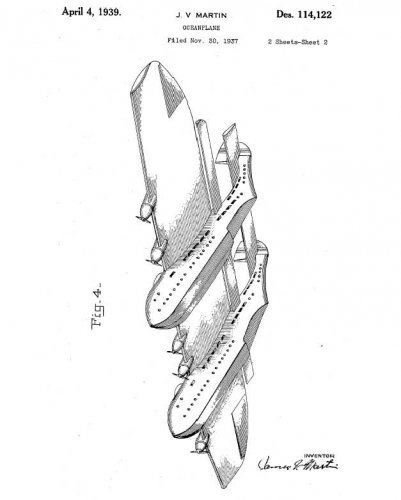

This is the other draft in the patent. In the brief description there is no hints to specific "patentable" features in this design.

I think this is a registered design. I can't see it getting a patent - prior art; prior publication; and it's not merely an application number. US I expect, though Martin seems to have introduced it via UK and Churchill.

The Patent source I found on the Web was written "Design 114,122" b
This is the one my drafts come from. The patent is about an ornamental design for a seaplane, i.e. registered design.

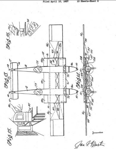

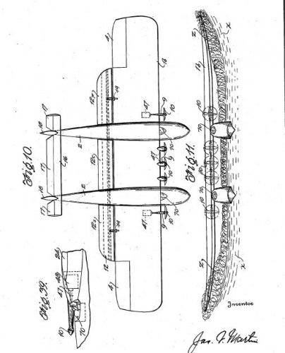

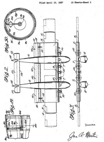

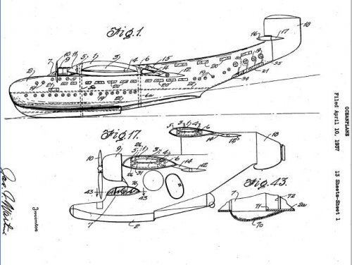

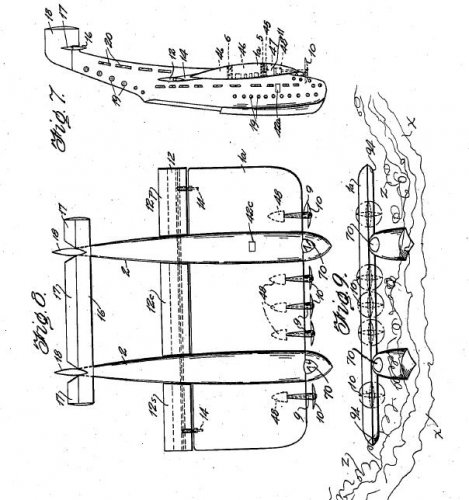

The Martin Oceanplane patent;
http://www.freepatentsonline.com/2231524.pdf

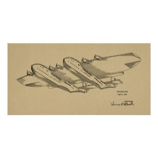

The same designer or not ?,I can't see well.
  • 1939_ocean_airplane_patent_art_drawing_print-r38badab0a4844ab4ad03a48e682861f5_t99_8byvr_324.jpg
