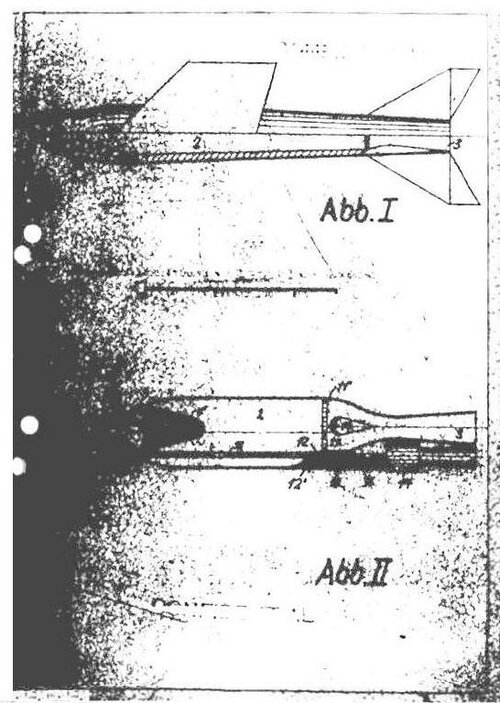

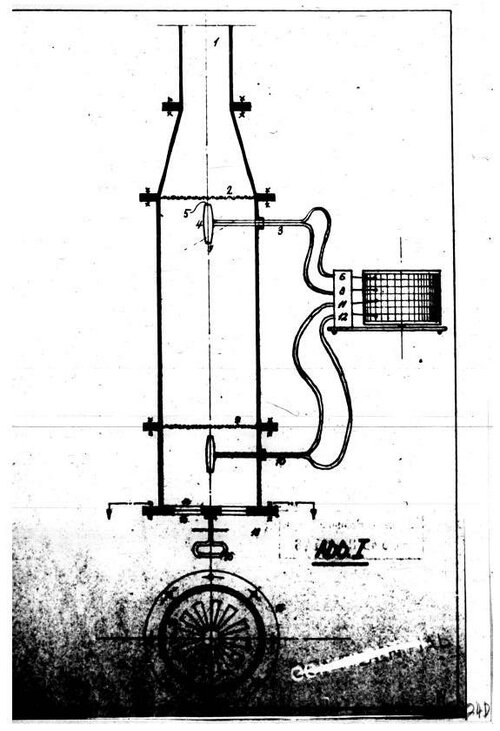

During the war years, there were some proposals for rockets designed by Hermann Oberth. Why these proposals never came to fruition compared to the other proposals, there are surely reasons for this which remain to be discovered by historians in the archives of the Peenemünde period. In a report of 1945, it is question of an anti-aircraft rocket and a long-range projectile with a rather particular propulsion device, a wood-burning jet unit, an idea of a section chief of WASAG, Dr. von Holt, the text of the report is very readable but the copies of the drawings are of poor quality.

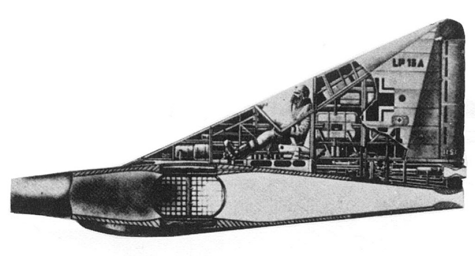

This ranks up there with that plan to run the Lippisch P-13 ramjet fighter on coal:
The idea here was a basket full of pulverized coal would be lit and as the heat source for the ramjet engine. Of course, this was completely insane given Germany's lack of high temperature metals for one, and just trying to get the heat produced to be even not to mention having no real good idea how long the coal would take to burn...
I need to find the reference, but from memory, the coal-containing basket was to rotate on a vertical axis, to ensure even combustion. You can see the axle in the image . . .

Cool! The engineers should have included room for a stoker and a coal bunker though...

Oberth also did not fully agree with the idea of the device suggested by Dr. von Holt for many reasons, which is why he made other modifying proposals for a possible good functioning of the principle as mentioned in his report.
