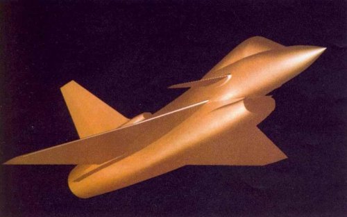

Here's a CGI image of the YCA (Yugoslav Combat Aircraft) from a Dassault brochure via Flateric (thanks!)

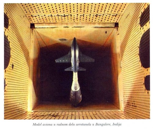

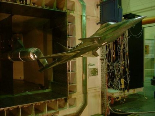

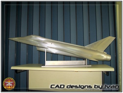

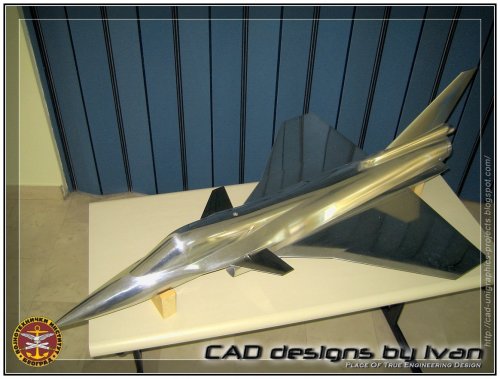

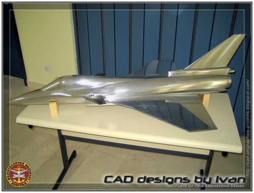

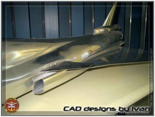

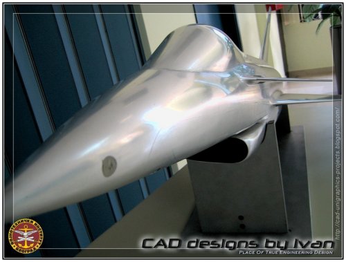

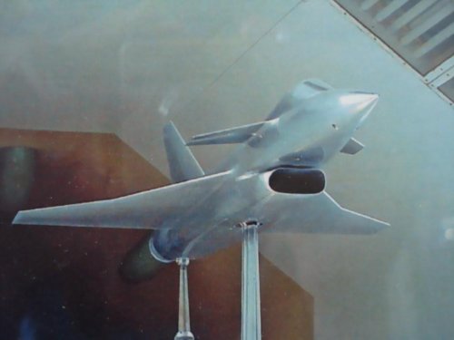

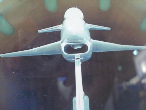

Some great wind tunnel model pics on that blog, including the early ventral intake version and the later "Rafale Lite" version.

Regarding the engine, I have read on another blog that the SNECMA M88 was the strong forerunner, not least because there was definite interest from South Africa for it to power the Atlas Carver. The French would turn a blind eye to what would have been a big order. The blog goes on to say that the deal was effectively scuppered as Yugoslavia wanted far too much to facilitate the deal. So much in fact, that it would finance a great portion of the Novi Avion project.
Not sure how true this is though, although both aircraft were broadly similar in role and timeline.
At first, they wanted to do everything alone, the second phase was the cooperation with Dassault (engine and avionics, but not the CATIA software) the third phase was the inclusion of India in the deal (similar to the joint cooperation with Romania on the Orao ground attack aircraft).
Yugoslavia invested heavily in the modernization of its civilian and military research institutes in the eighties as preparation for the production of NA (a few billion dollars in 1990 exchange rates, including new Mach 4 tunnel). I have a 20 page article, split in three about the pressclippings from the late eighties and early 1990s about the project. The intent was to invest a few hundred million dollars annually for ten years. I've never found any source that says the France would fund the project.
The big question is, how would this aircraft fare on the world market today? If it could be cheaper than Grippen and share no problems with the engine and electronics procurement like J-17 had? How many countries have outdated fleets and have no money for the Rafale or the upkeep of the older fighters?

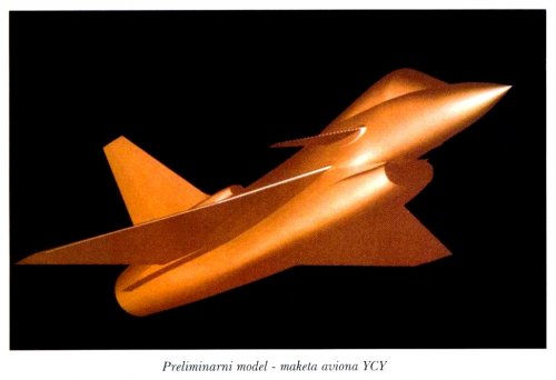

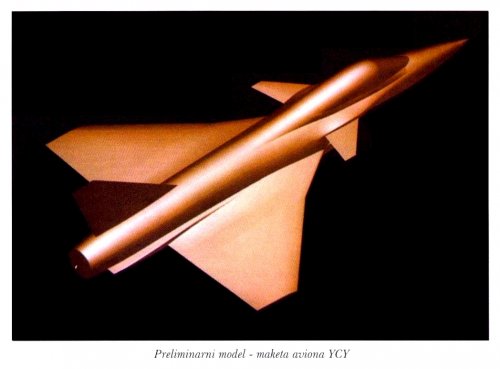

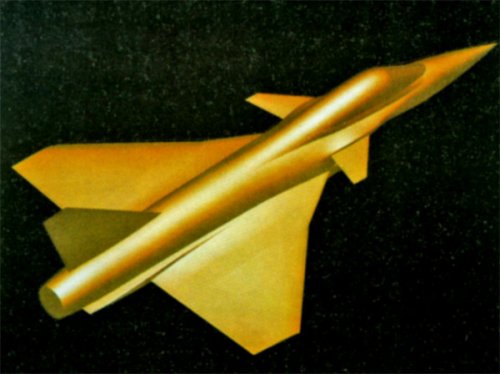

While browsing through various magazines, I came across an article from the Yugoslav Aero Magazin N°2 dated March/April 1998. I don't speak Yugoslav but it seems like the article describes various stages of a program known as "YU-supersonic". Several pictures illustrate the article, among which two models depicting the so-called YCY (presumably Yugoslav Supersonic Fighter) in two different configurations. Then two wind tunnel models appear, one taken in Zharkov, the other in India.

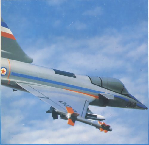

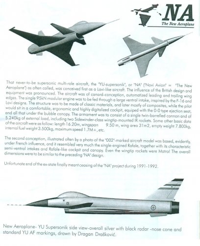

Here is an advertisement for the so-called "Novi Avion" ("new plane") that appeared in Aero Magazin N°3:

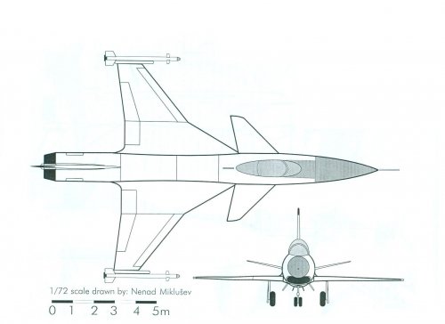

Earlier drawings of Novi avion were made before the cooperation with France. Later pictures show a lot of similarities with Rafale.

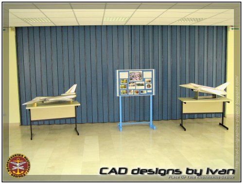

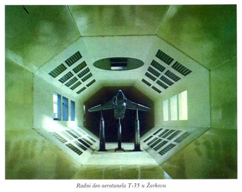

Small presentation in English of the wind tunnels built for the testing of Novi Avion

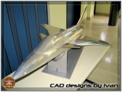

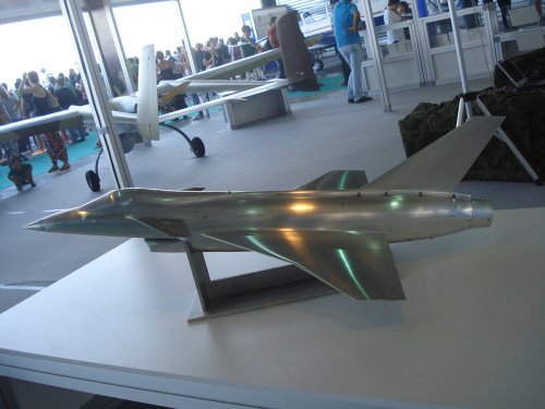

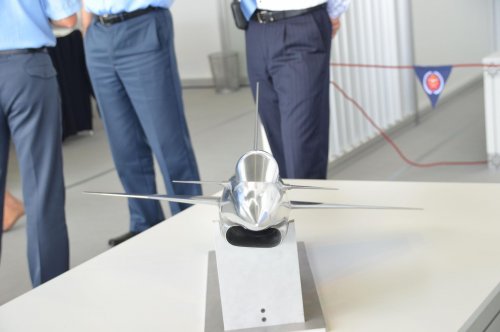

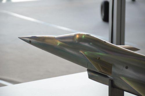

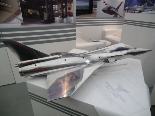

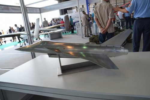

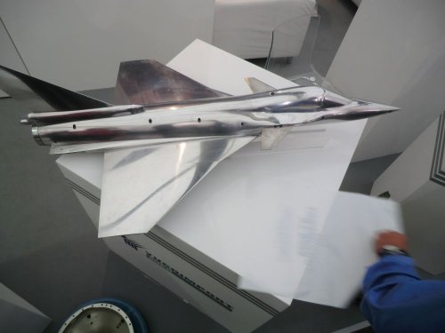

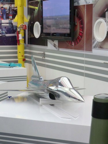

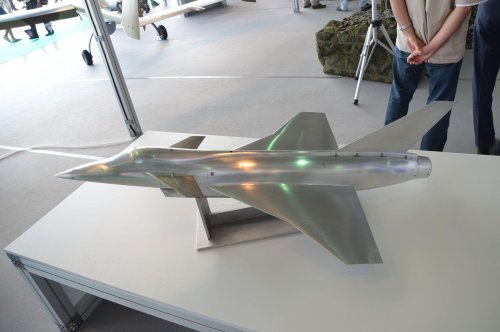

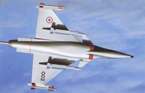

The wind tunnel model in the "Rafale configuration" was shown on the ILA 2012:
A good question, which unfortunately I cannot answer. It was the only wind tunnel model to be
shown, besides some other models, e.g. of the Utva Lasta 95.
Maybe the reason really was to demonstrate the competence in designing military aircraft.
Nice. But what was the reason for that? To show the competency?
Yes. Serbia does not have the capacity to pull this project off. But the few billions of dollars worth of infrastructure that was built and purchased for this project in the eighties (mach 4 windtunnel for instance) is still operational. They are pitching for some work.

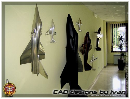

More windtunnel model pics from Batajnica Air Base

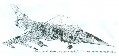

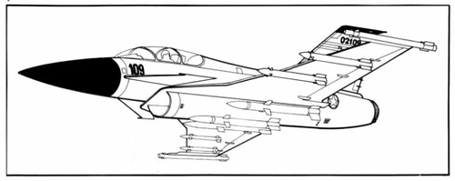

I have the especulative cutaway drawing Novi Avion....!
