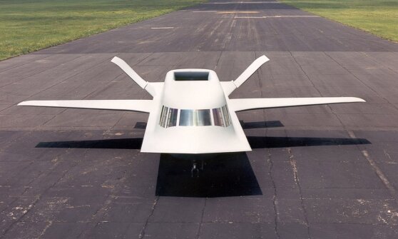

That’s the first belly pic I’ve seen…a big manned cruise missile ;)

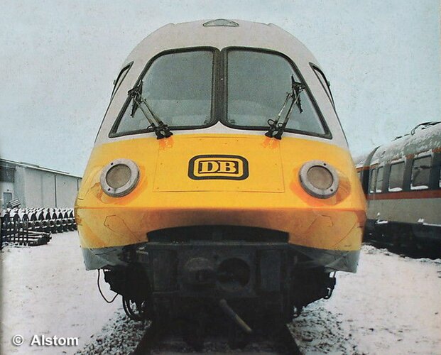

You are not far from the truth but in Germany its called ET403 aka the father of the ICE
Aw man, in the 1980s and 1990s I had one of those in DB paint scheme with red window band in HO scale by Lima; it vanished in a move.
Great looking train. Miss the model to this day. And very much remember it having picked up "Donald Duck" nickname.

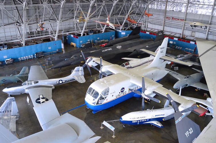

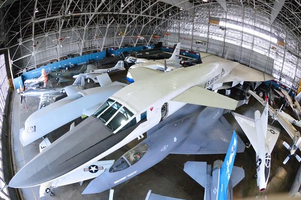

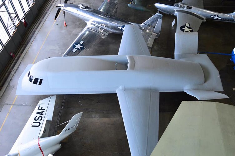

USAFM R&D hangar as of 2015
All the R&D stuff has moved into the new hangar 4 at the main museum complex. Which is partly unfortunate - in the R&D hangar, there were no barriers or anything. One could crawl around under the aircraft and take pictures of weirdo antennas and markings.

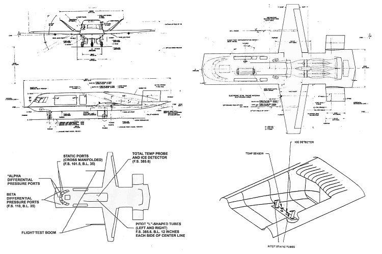

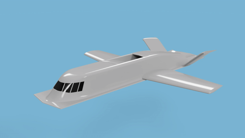

Thanks to all the folks that posted drawings. I was thinking of an RC version of it so I did some CAD work to figure out scale and parts locations.
You'd work on wing/fuselage/chine interaction
