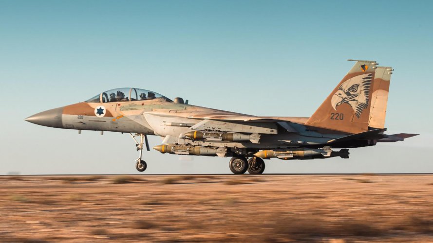

Maybe not connected to the photo, but the IaF raid that took out Lil Naz reportedly involved a dozen F-15s wearing seven 2,000# class penetrators - wings, centerline, and CFTs. But the IAF has a lot of freedom of action over Kebanon in terms of resistance and distance. That is not a configuration you would want to use if there was any chance of someone shooting at you or if you needed any kind of endurance.
