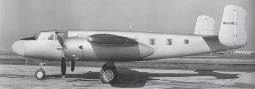

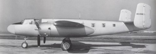

There is a picture of 44-30975/N5126N on page 90. Will post it as soon as I am allowed to.

As promised, a bit earlier than I expected. Thanks for your kind welcome :)
<edit>Oops. I've been reading the do's and don'ts. Replaced the original image by a less substantial one. </edit>
Stargazer2006 said:
Amazing picture of a very rare bird. Wow! Thank you so much.

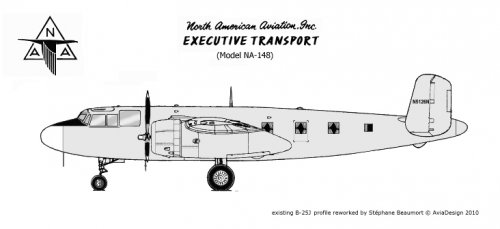

First of all, this long-dreamed of photograph has inspired me to no end! I just HAD to do a profile of the NA-148, however imperfect (it is based on the photo, not on actual dimensions and cannot therefore be trusted for reference). I hope some of you will enjoy it, it's my last work on the computer for a while since I'm undergoing hand surgery tomorrow morning...

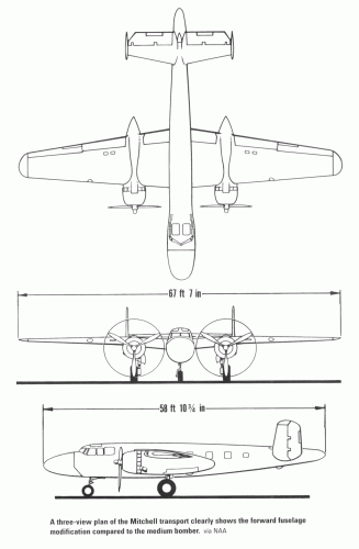

The book contains a see-through artist's impression on page 159 and a 3-view drawing on page 160. Length of the conversion is given as 58ft 103/4in, (unchanged) span 67ft 7 in.

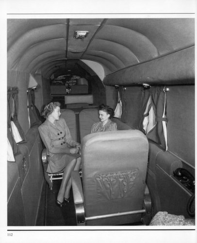

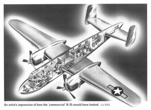

More pics of the North American NA-148 Executive Transport from Jerry Scutts's North American B-25 Mitchell Crowood book:
