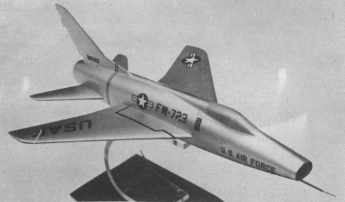

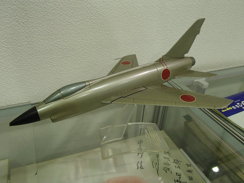

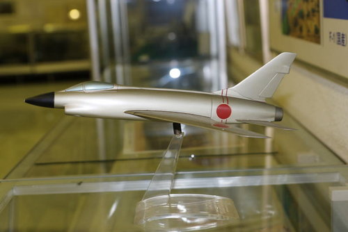

This display model was shown in aero August 1964. It's not really labelled but a short description is given on a Super Sabre with RR Spey engines. Such a proposed version is mentioned in The American Fighter by Angelucci & Bowers as F-100S.
So I want to ask if it's the F-100S in the picture.
In 1964 NAA proposed a newbuild F-100S SuperSabre fitted with a Rolls-Royce RB.168-25R Spey Turbofan (or optional Allison TF41).
Well, timing is correct. Hard to tell with a small model though.
My dear boxkite,
the NA F-100S was based on F-100F airframe with a Rolls-Royce
engine,so the model is not clear.
Is 'engines' a typo? The F-100 pictured appears to be a single engined a/c.
Yes, a typo. J57 & Spey must be reasonably close in size, several J57 engined aircraft were proposed with Spey.

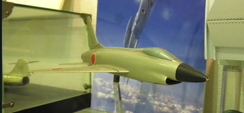

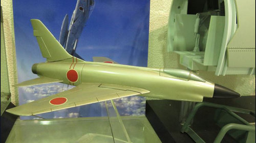

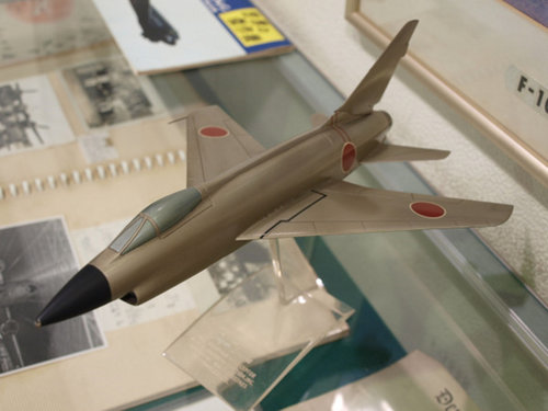

Great post Blackkite!

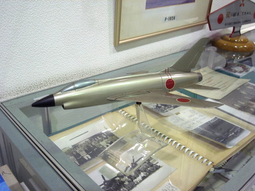

Is there any explanation for the large radome on the model, compared to the small one in the scanned images?

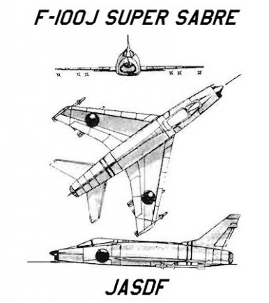

The drawing of F-100 with small radar dome title is "三菱式 F-100 改 推定図"
The meaning of this title is "Mitsubishi type modified F-100 estimated figure".
Also there explanation included.
1. FCS : possible automatic tracking operation
2. All weather fighter
3. AAM : 6, 20mm cannon
4. Engine : J57 power up type
5. Vmax : 1.16 Mach
6. Climbing performance : higher than F-104
7. Combat radius : 700n.m with full weapon
8. Range : 2200n.m
9.It's possible to advance 200n.m, 3 hours patrol and return
10. Weight : 13.5ton
11. Price per one fighter : 700,000 dollars at the day
The model and the illustrations are quite interesting. They remind me of a picture I saw of a modified F-100 with the gunsite radar replaced by a more capable one, resulting in a bulged radome on the top of the inlet.
Some modeller says that this is a F-100J.
Excellent model!! However, I recommend remodeling the nose and the canopy.;)
Japanese explanation says that this model is a Tamiya (Italeri) 1/72 F-100J model completed in May 2017.
I want these model makers to work more seriously. Isn't it embarrassing to put such a model into the world? Investigation and study are crucial.
Excellent speculative drawing which made 6 years before.
The explanation of this picture is as follows.
The F-100J disappeared with a vision in the voice of the famous Prime Minister Kishi's crane.
Also with the bonus of the phantom AAM-2. Please take care that AAM-2 was for F-4EJ.

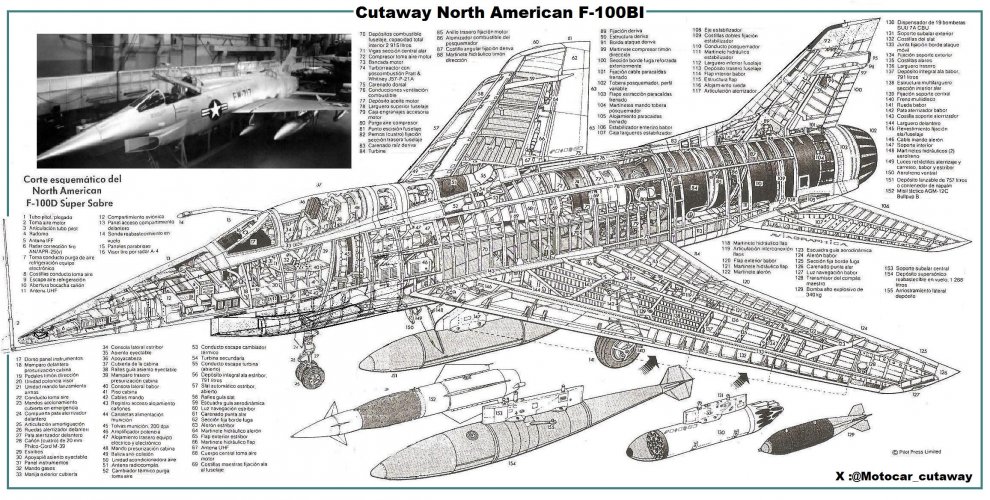

Hey fellas

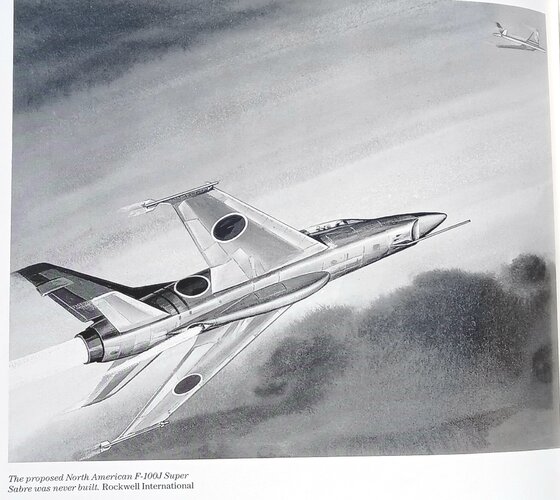

I don't want to get too far into speculating on paper projects but does anyone know what potential radars were on the table for the F-100BI and F-100J proposals?
The F-100J, as shown in Lockheed F-104 Starfighter by Steve Pace (Motorbooks International, 1992). So far as I can tell, it looks like what we've seen so far of the F-100J. But the ventrally-mounted rocket pack is curious.
