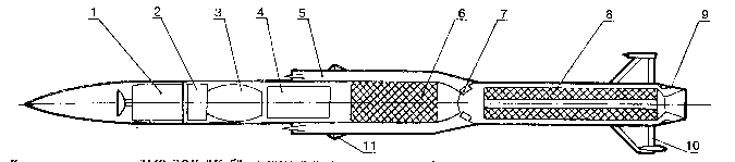

Er, isn't 2K12 "Kub" (SA-6 to NATO) also ramjet powered? And guided by semi-active radar homing?
Yes, but it have different configuration, with air intakes mid-hull:Er, isn't 2K12 "Kub" (SA-6 to NATO) also ramjet powered? And guided by semi-active radar homing?
