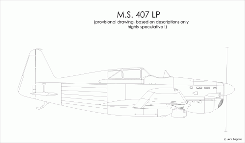

From that description, I tried to make a quick sketch without any claim for accuracy. I took the standard MS.406, removed
the antennaea, because they probably would have been in the way, when ejecting a dummy, hint at a beefed up wind shield
(in the original cockpit) and tried to add a hatch on the underside. Maybe these tests just should give a clue, if upwards or down-
wards ejection would be better ?
Replacing the fuel tank wouldn't have been much of a problem, I think, the weapon bays could have been used and, as mentioned
the space under the seat. And for such tests long range probably wasn't necessary.

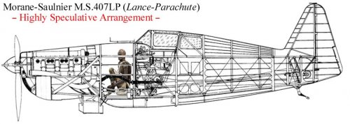

Great interpretation Jens! But I have a few quibbles :D
I'm not sure about the added windscreen. A mannequin could be 'packed' in a more compact shape than the real pilot - eg: a fetal position. World War Two parachute mannequins varied from articulated, 'crash-test dummy' style to stuffed-cloth human forms to simpler man-weighted shapes. Any of these types would fold up nicely into a Morane-sized space ;)
Next question, is a top opening needed at all? Perhaps that belly drop hatch could also be used for loading the parachute-equipped mannequin as well? (And that drop hatch would need to be directly behind the coolant radiator to avoid interfering with the operation of the rudder pedals). If the drop hatch could perform double duty, a simple loading hatch could have been installed in the upper decking.
As for the windscreen reinforcement, this may have had nothing to do with the mannequin per se. Instead, perhaps this reinforcing was purely structural - dictated by reduced rigidity in the former fuel tank bay? Attached is a rough retouch of an M.S.406 fuselage section view with a roughly-to-scale 'compacted' mannequin added.
