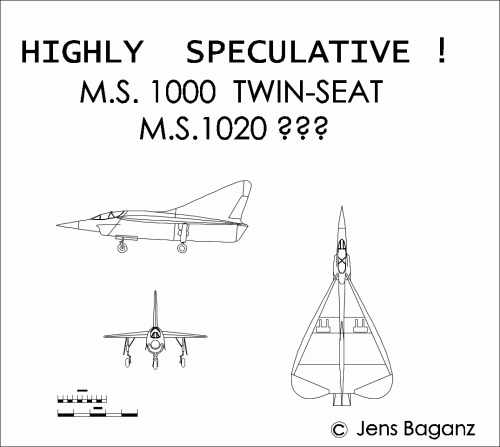

Just as a pure speculation, a twin-seat MS.1000, maybe the MS.1020 ? ;D
NOT TO BE TAKEN SERIOUSLY, BUT ANY ADDITIONAL INFORMATION HIGHLY APPRECIATED !

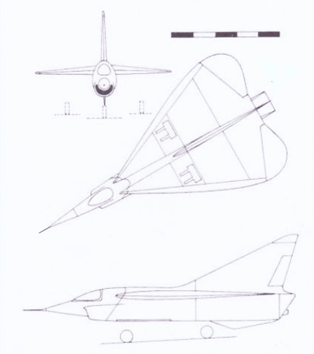

By the way, a correction with regards to the MS.1010: In "Morane Saulnier-Ses Avions, Ses Projets"
by Henri Lacaze, it isn't mentioned as a VTOL (ADAV) type, but as a two seat delty winged aircraft
with two engines, similar to the MS.1000, but with the intake located further aft under the wing.

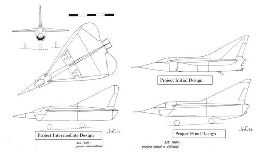

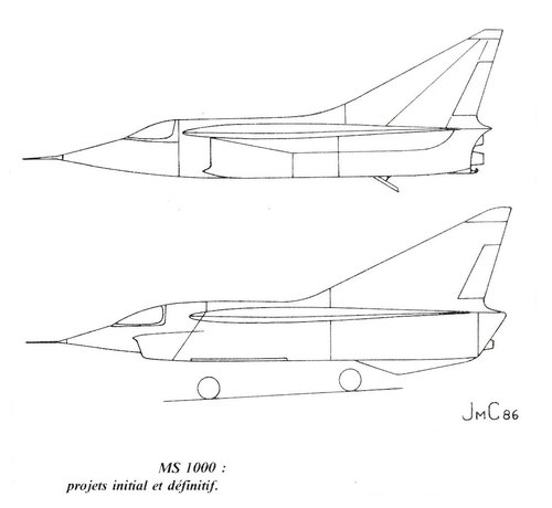

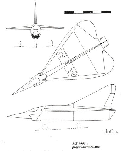

For some reason, in his book, Cuny-san posted a three side view drawing of the intermediate design as a three side view drawing of the MS1000 fighter, not the final design. Therefore modelers and painters are creating models and drawings of the MS1000 fighter based on intermediate designs. It's very strange.
The final design expanded the area of the vertical tail stabilizer and added ventral fins.
Source : LES AVIONS DE COMBAT FRANCAIS 1944-1960, Ⅰ-CHASSE-ASSAUT, Jean CUNY.

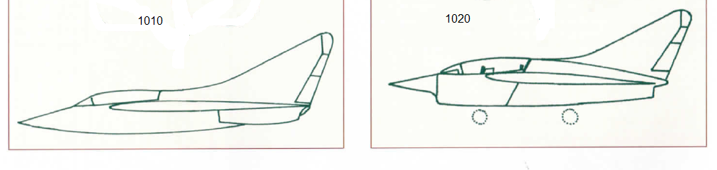

I can't show a whole drawings to MS 1010 & 1020 from Morane-Saulnier's book,but just
a profiles to them.
