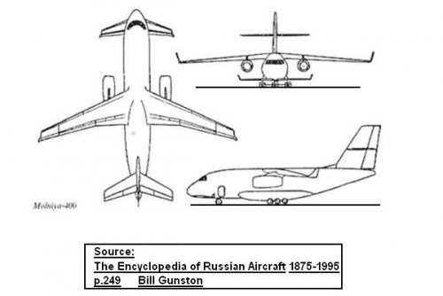

Hi Everyone!
I found a fairly good basic three-view of this aircraft.
I'm not too clear as to whether this violates the author's copyright, so please remove this three-view if it does!!!
Thanks!!
Chuck
SOURCE:
The Encyclopedia of Russian Aircraft 1875-1995
pg. 249
Author: Bill Gunston
