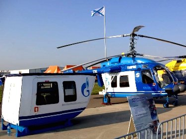

EDIT - The closest thing I have been able to find among contemporary aircraft is the removable, interchangeable fuselage pod on the Kamov 26/126/226 light helicopters.
