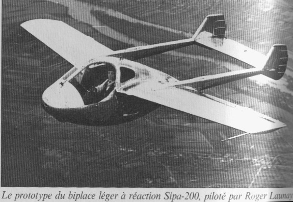

I've always loved the SIPA S.200 Minijet despite the fact that it was overweight and underpowered.
I daydream about a modern version with composite construction and lightweight systems to cut the weight (in half?) and a single FJ-33 to double the power. A two-seater with an internal MG and a pair of hardpoints would be good for training, including weapons training, while a single seater with armor, self-sealing fuel tanks and a couple more hardpoints would be great for counter-insurgency, helicopter-hunting, drug interdiction, you name it.

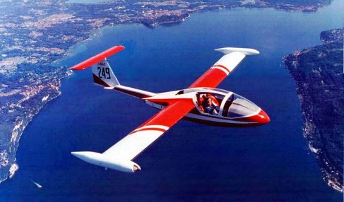

speaking of lightweight jet powered aircraft...
The Caproni Vizzola C22J was derived from an metal glider with the addition of two microturbo engines and hardpoints under the wings. interest failed to materialise and the project was canned.

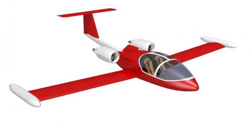

C22J with two Price Induction turbofans ;D
--Luc

But I'm still dreaming of Rutanized SIPA S.200 Minijet....
