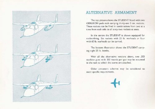

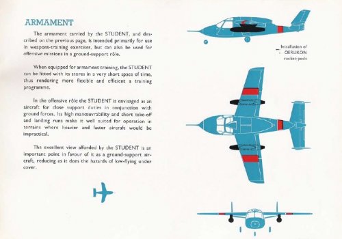

After much searching in my attic, I have found an old 1958 Miles brochure for the M.100 Student.
In the introduction it states that a future development would be the "more improved Centurion".
However, the brochure also has proposed armament for the basic M.100 Student together with a view of Student undertaking a ground attack viewed from the cockpit of a following M.100.
I attach the relevent pages and hope they are of interest.

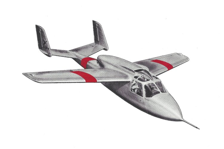

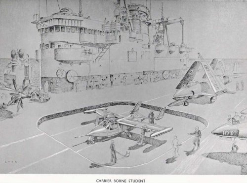

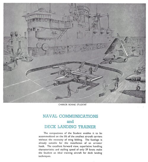

In the meantime there is one other image I was going to post, the accompanying text read:
Carrier Borne
The compactness of the Student enables it to be accommodated on the lift of the smallest aircraft carriers without folding any portion. The fuselage is already suitable for the installation of a hook. With its excellent view, stalling speed only 59 knots, superlative handling characteristics, the Student is ideal for deck-landing training.
From 'Learning From The Student', Aeroplane Monthly, May 1975, pp 220-224 :-
"It could be used as a two-seat basic trainer powered by either one Blackburn Turbernéca Marboré 2 engine of 8801b static thrust or two Palas 600 engines, or a four seat communications aircraft known as the Graduate and powered by a 1,5401b thrust Turboméca Aubisque engine.
The Student could also be offered as a light ground attack aircraft, where the excellent forward visibility, light wing loading and manceuvrability were an advantage. In this case the armament was to be carried in underwing pods."

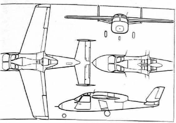

robunos said:
"In July 1957 the Centurion range, a new, developed and more powerful range of the Student design was announced.

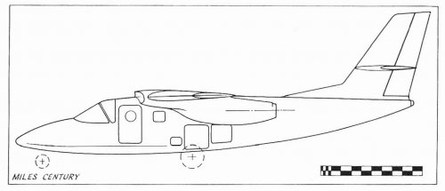

Wonder if this is the same (or related to) the Miles Century project?

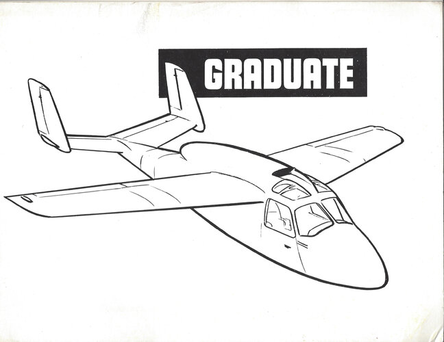

My dear Boxkite,
the Miles Graduate is a variant of Miles Centurion,a four seat liaison aircraft/business
jet project,but with a larger fuselage and powered by a Turbomeca Aubisque engines,
and for Satgazer,the Miles Century is not related to them,but it was a new design of
1963,and in 1964 the mock-up was built,and Scottish Aviation was invited to partner
the project.
a bit more about the Century.
F.G.Miles: Century
... A new design,the Century was put foreward in 1963 after a commission from Col.J.Scott of Johannesburg
and was to be a six- to seven seater executive twinjet able to travel over 1.600miles at 450 mph.
In 1964 a mock-up was built at Shoreham,and Scottish Aviation were invited to partner the project.
Power would have been provided by two Turbomeca Aubisques of 1.540lb thrust.
The design ,of high wing layout with a single fin and mid tailplane , attracted interest of joint funding from
governement, and studies were made as a joint venture with France , but the
company was unable to fund its share of the project.
Span: 40ft.
so far :Richard Payne in 'Stuck on the Drawing Board' Tempus 2004.U.K.
P.S. :Air Enthusiast N° 69-70 produced also a lot of info about the Miles Student /Centurion/Graduate and Century.

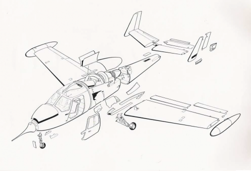

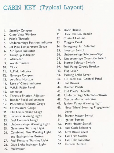

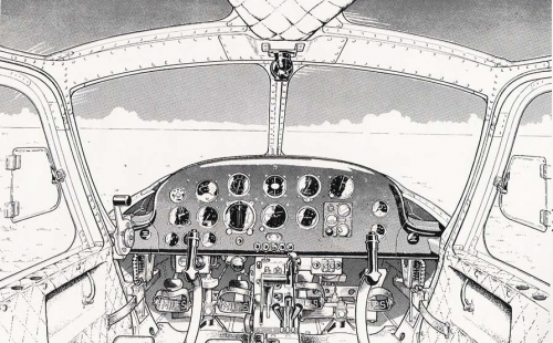

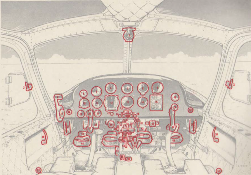

Some more from the 1958 Miles Student brochure...(only a year late!)

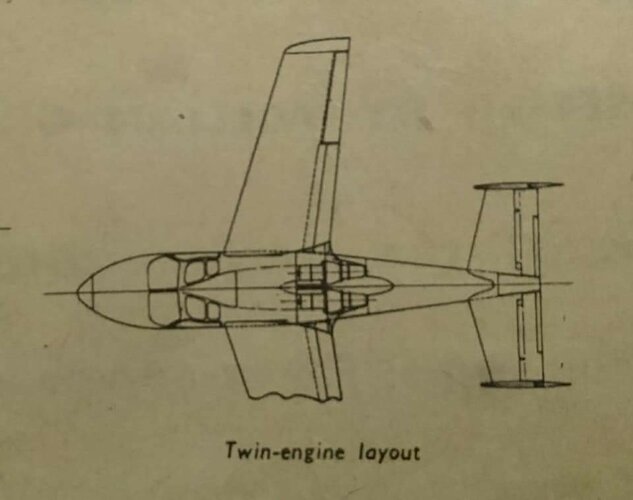

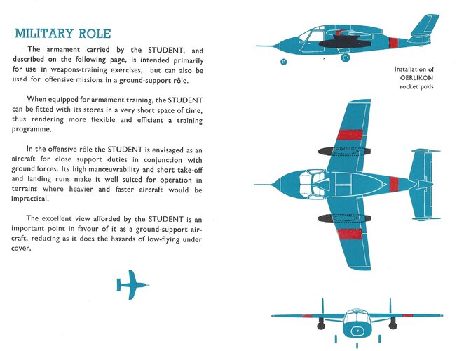

Providing more images from what is probably the same document Cy-27 provided above - Miles Student.

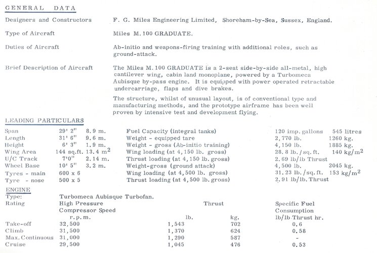

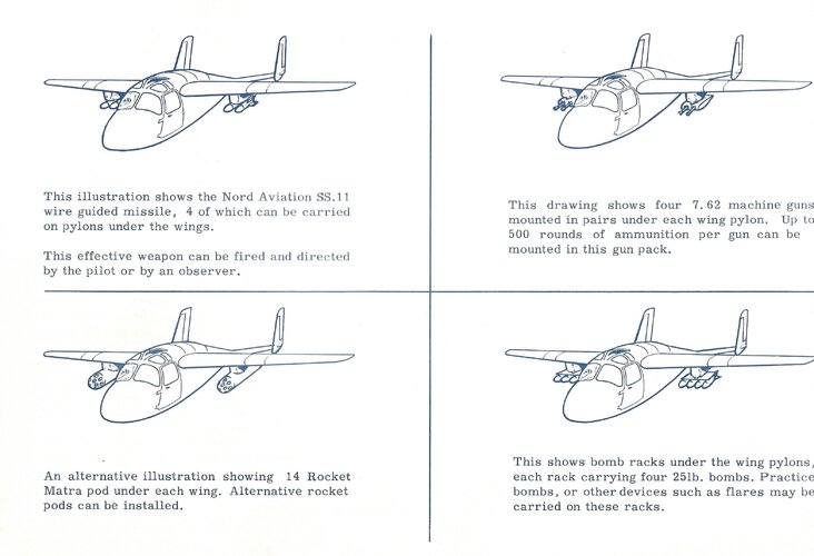

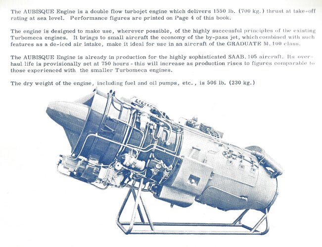

And some info on the similar Miles Graduate.
