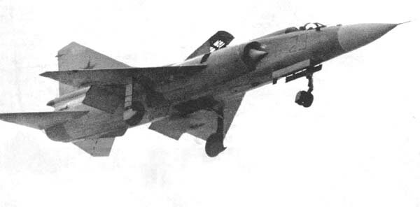

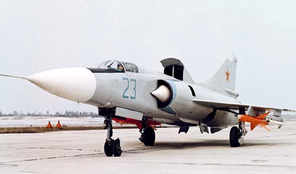

What is the name/designation of the aircraft in these pictures? I am trying to find more photos but I cant search properly because I don't know the name.
MiG Faithless will get you there.
thank you very much!
Technically its the Mikoyan-Gurevich Izdeliye 23-01 or MiG-23PD (first MiG-23 prototype).
Made 27 flights in total, which proved the idea wasn't great.
My first thought was that the MiG-23PD looks very much like a Mirage F1, with lower mounted wings. I wonder if the removal of the lift fan and the mounting of the wings and a more powerful engine could have improved (and possibly simplified the design). It could be that the parameters laid out by the VVS were too dissimilar from a Mirage F1 style fighter.
