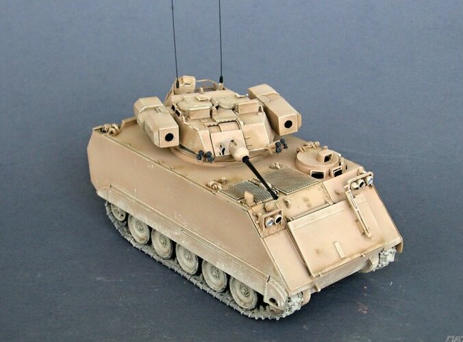

Do you mean something like a YPR-765 hull equipped with a Delco turret mounting a 25mm chain gun and two TOW missile launchers.
Regards
Pioneer
