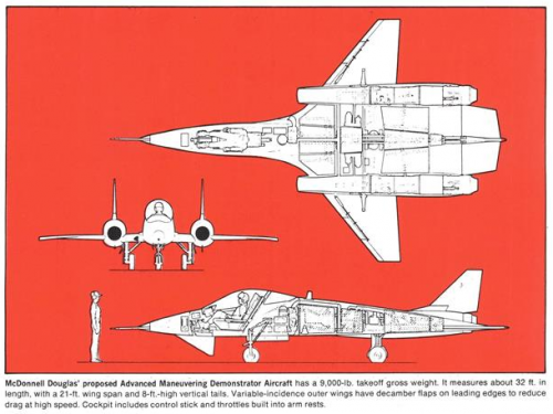

A sepia-colored version of the illustration posted by Mark Nankivil in Reply #57, straight from a McDonnell Douglas publication:
Source: http://aviationarchives.blogspot.co.uk/2013/11/mcdonnell-aircraft-40th-year-booklet.html

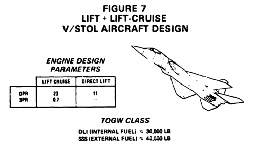

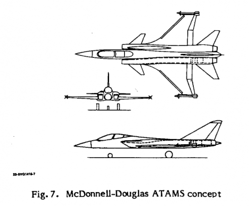

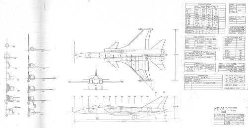

This tail and canards design seems to be an ATS related study - ATAMS (Advanced Tactical Attack Manned Systems). Weight was 41,000 lb and payload = 4000 lb.
The McDonnell-Douglas ATAMS weapon system concept shown in Figure 7 resulted from a comprehensive air-to-surface technology and integration study. Study results included a mission definition and a vehicle concept that is affordable, able to penetrate enemy defenses, survive, and destroy important targets in large numbers in both fair and adverse weather conditions. The design mission of the ATAMS is a low altitude interdiction mission for a NATO/Warsaw Pact conflict in central and northern Europe. The ATAMS is powered by two augmented turbofan engines.
Source: AIAA Paper 1981-1503 Progress Toward a Long-Range Propulsion Plan, C.F. Baerst, R.C. Gunness,and S.W. Mitnik, Garrett Turbine Engine Co
The Advanced Tactical Attack Manned System is a tactical fighter having both air-to-air and air-to-ground roles. Mission is the air-to-ground strike mission (Figure 15) in which the aircraft cruises
subsonically to the forward edge of the battle area (FEBA) and dashes at Mach 1.7 to the weapons release point. Since STOL is not a requirement for the ATAMS. the aircraft is somewhat imaller than those being considered for ATF/STOL missions.
Source: AIAA Paper 1981-1502 ADVANCED TECHNOLOGY ENGINE STUDIES (ATES) A STATUS REPORT William S. Wlllis General Electric Company

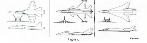

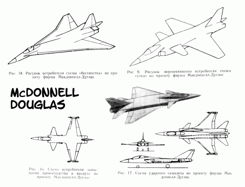

Various McDonnell Douglas pre-ATF designs from TsAGI's Tekhnicheskaya Informatsiya (No.13, 1984):

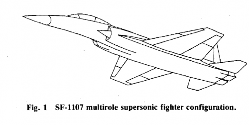

hesham said:
here is a drawing to SF-1107 fighter.
The SF- prefix was used by Vought (LTV) for their "Superfly" series of designs. The air intakes are very different from the SF-106 and SF-120/121, but are you positive this is McDD?
Skyblazer said:
Indeed, the MDD SF-1107 is already mentioned in this same topic (as well as the MDD SF-1302)
http://www.secretprojects.co.uk/forum/index.php/topic,399.msg69229.html#msg69229
Thanks folks. Interesting designations, with "SF-" probably meaning "Supersonic Fighter" for McDD.

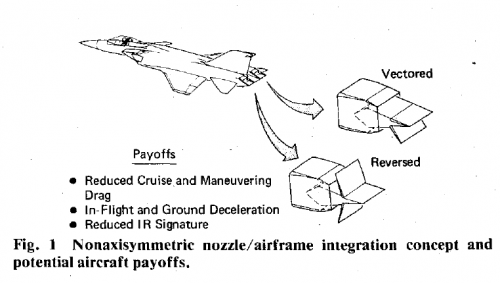

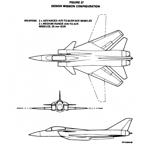

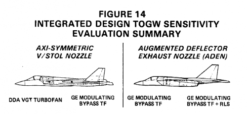

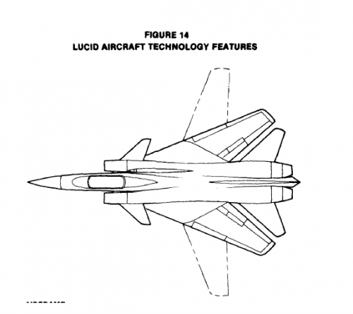

here is a study for Nonaxisymmetric nozzles installed on hypothetical fighter,
may be based on McDonnell-Douglas F-15,and done by MD and co-operate by Pratt & Whitney
Aircraft,I am confuse from that; is it suitable in this topic or not,I read the article,
but I don't know what to do ?.
http://arc.aiaa.org/doi/abs/10.2514/3.58740?journalCode=ja
It's not in any way F-15 related. Looks like a notional fighter derived from Model 263 configuration. Probably part of early ATS studies.
Yes my dear Paul,
very close to it.

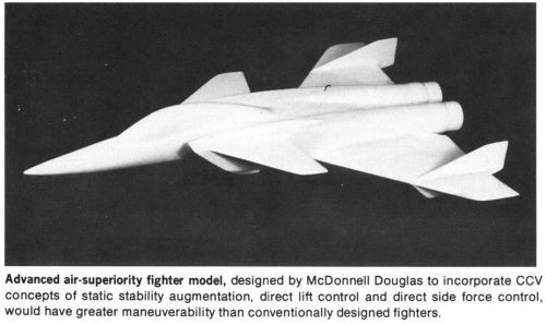

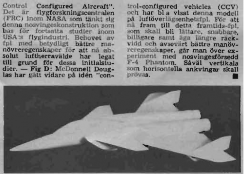

Flygvapennytt 2-1973

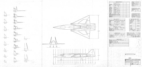

Mark - that stealthy concept is very interesting. Some of the other designs look familiar from 70's ATS studies, will try to unite any other information here.
The canard design (Model 252-109A) seems to be the same design featured in the "ATAMS" concept and nearly identical to this artwork.
Model 252-109A ATS
ATAMS
Model 252-111B seems a lot like this, previously identified as Model 269-F2 ATS study:
Model 252-111B
index.php
Model 269-F2
index.php
I believe Model 252 represents Phase 1 of McDonnell-Douglas ATS work and Model 269 Phase 2. Clearly Phase 2 reused and refined configurations from Phase 1.
Model 252 designation was assigned in 1970 with this entry in the McDonnell Project List:
USAF Advanced Tactical Strike Aircraft (SX) (13/02/1970 D. Redden)
Model 269 designation was assigned in 1975
USAF Tactical Fighter "Battlefield superiority fighter tailored to ground attack and reconnaissance roles with alternate capability as air superiority - deep strike - strategic" (13/10/1975 P. Czysz)

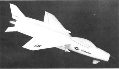

A 1971 USAF project, probably strike oriented, via Mark Nankivil.
(A belated) nice find Mark!!
It has a somewhat fixed-wing TFX/F-111 look to it
Regards
Pioneer

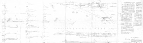

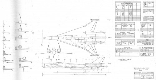

Good Day All -

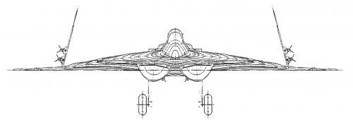

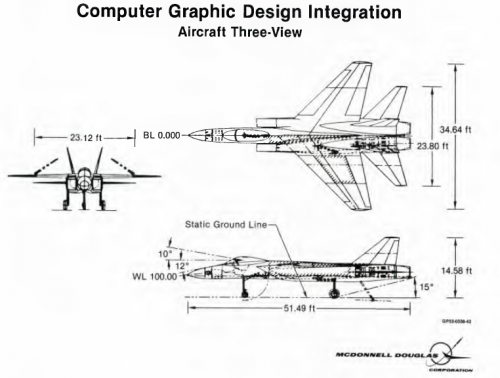

Another McAir design - Model 272-6000 ATF concept. Note the missiles being mounted to the outboard of the canted vertical fins.....
Enjoy the Day! Mark
Another great find, you're on a roll Mark. Thanks. :)
The sidewinders mounted to the outboard face of the vertical tails is interesting, to say the least.
galgot said:
It's beautiful ! That wing shape shouts SCAT nasa studies.
Well, there's note to the left of the drawing data block that says:
Note:
1. Modified DAC AST Airfoil t/c 4% (ref NASA CR 145094)
Any connections whith photo
xD4C 97224 from Aug-1972, or xD4C 97574 from Aug-1972?

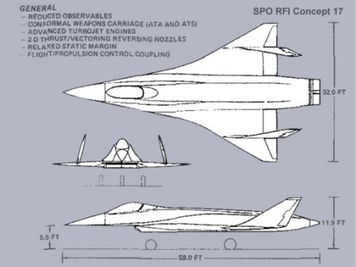

hesham said:
was this a McDonnell-Douglas ATF design ?.
https://i.pinimg.com/originals/e6/6c/40/e66c4060e1375f9372d59e515ea99c15.png
No, well, not their actual submission for the program.
It was from the design study right before the ATF program began. You've seen the graphic here plenty of times that shows this design to scale with the Northrop, Grumman, Rockwell, Lockheed and Boeing designs in planform.
