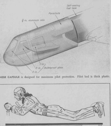

Martin proposed an interesting concept for close air suport in 1952.
The twin engined jet aircraft was designed for simplicity, short field
performance, low vulnerabilty, high maneuverability and provision for
a wide variety of different weapons, including side firing guns, as later
introduced in the AC-47 . The pilot was housed in prone position in a
heavily armoured cockpit section, which in the case of an emergency,
could be jettisoned .
An early form of the Wharthog !
(from AviationWeek November 1954)

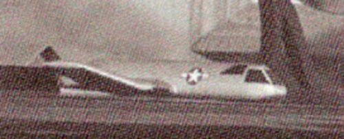

Photo of the display model.... found it in a very peculiar place... 8)

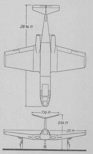

Martin Midget I and Midget II ?
"Martin Midget I and Midget II ?"
There's no mentione of other or earlier variants, but this projects seems to
have been around for wo or three years and it is said, that the concept
found favour with the air force. Budget restrains and the lack of a small,
powerful and fuel efficient engine precluded a realisation.

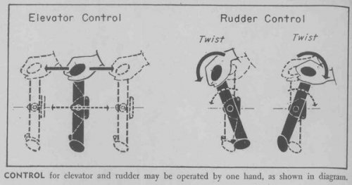

The concept with the prone pilot was hosen for two reasons: I enabled the
pilot to stand higher g-loads and it reduced frontal area, which meant a smaller
target, that could be easier protected with armour plates. The same idea was
used in the german Blohm & Voss Bv 40 glider fighter.
Interesting too, is the concept of the elevator and rudder control, as rudder
pedals obviously were not suitable.

By the way, nice picture, Apophenia ! But I really would like to know, where Skybolt
found the photo ....

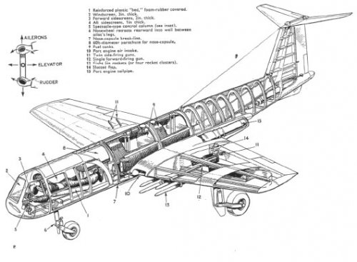

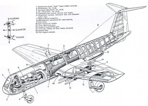

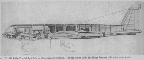

But I have more up my sleeve, a gorgeous sectioned view from "Flight" (not "The Aeroplane".. sorry) 8). Courtesy of my friend Lark.
Jemiba said:
... By the way, nice picture, Apophenia ! ...
Thanks Jens. I wish I'd seen the Flight cutaway posted by skybolt first -- I've left off the tailskid for starters. :-\

BTW, the model that is shown, it's hard to make out, but is the tail an "A" tail on twin booms on the model?
I enlarged the detail but the definition goes bust... Take it with a grain of salt, but it seems that the fuselage drops just before the tail and that the two rudders start each from a sponson attached to the rear of the wing root. This arrangement could leave space for a twin exhaust just in the tail, or even a single exhaust for a single-engine version. Stan Piet, were are you ???

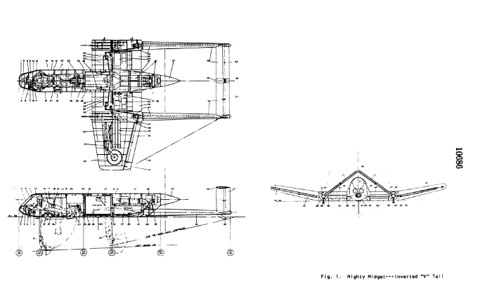

Why so few inverted V-tails?
Molt Taylor's IMP and a German akafleug (D-EKFS) are the only ones that come to mind.
... and the Blohm & Voss BV P 213.
