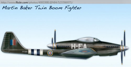

I found that on the Web, seeming serious. A push-pull interpretation of the twin-boom pusher?
http://www.flickr.com/photos/40933081@N04/5233569371/

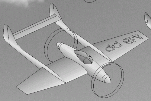

A provisional drawing of it was in my book "The end of Forked Ghosts" following words of Tony Butler, but I never saw such a precise drawing, and the mention of 2 side-by-side cockpits. I may have to update my drawing collection.

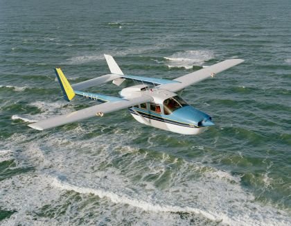

There's this Cessna 337, not to mention all those nice Dornier flying boats. Push-pull was a big thing in pre-war flying boats.
Yes, the Skymaster. I'm silly because I was about to mention it in the above post and then forgot about it...
Oh, the Dorniers. Yes! You're right. And they flew pretty well it seems. Now from a technical viewpoint, what is the effect of the front propellers' air stream hitting the rear ones? Is there any consequence, either positive or negative? I should imagine the stream is pretty much absorbed into it and it might even make it work better, but that's pure conjecture, so if anyone with knowledge on the subject could clarify this particular point, I sure would appreciate it.
Strictly as a layman: Dornier tried push-pull in the 335 which was one of the fastest prop-fighters ever, De Havilland made an even faster twin-prop with their Hornet. I don't think propellor-efficiency is fundamentally compromised by either configuration.
One big advantage for the Hornet was field of vision, the pilot of a 335 was stuck behind that long nose. Rolling inertia should be smaller for the 335. I guess much depends on what you want to use the aircraft for.

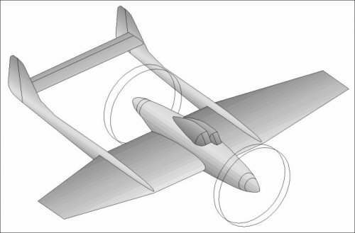

Here is a bigger view:

Yep, all the examples you guys have provided are true, but apart from the Cessna Skymaster, they're all mostly from Dornier, so it's still quite a scarce configuration... and one can hardly call the Wal a "production type"!
Stargazer2006 said:
if push-pull configurations were THAT efficient and easy to maintain, there probably WOULD be a lot more types using it nowadays! Yet if I'm not mistaken, there never was any true production type in push-pull configuration anywhere in the world!
On the contrary, if such a layout were THAT bad, why Burt Rutan would have used it nowadays for its 309th design (Adam M309)?

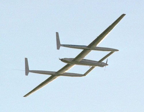

Not to mention the Model 76 "Voyager".
Photo NASA via Wikipedia

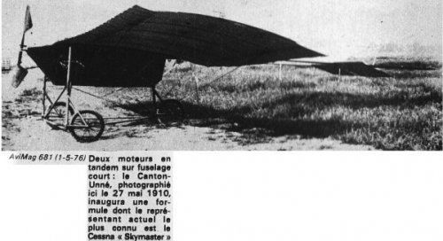

Below: the first of them all, from Aviation Magazine #681 of 1976

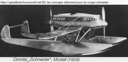

But I forgot a Dornier "Schneider Modell" (project), I plan to update my 'twin-boom files' this year at last... :-\

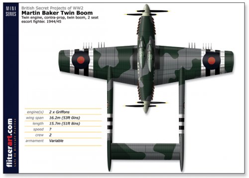

The common factor is that they all represent mechanisms to solve the same engineering problem, delivering the power of two separate engines out of a single longitudinal structure, whether that be a fuselage pod, full fuselage or nacelle.
Just in case they might help.
P

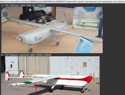

I am glad I just discovered (Google-ing) 2 new push-pull twin-boomers, in the UAV sub-class like the Hunter while very different:
(the push-pull layout still seduces designers, it was not wrong)

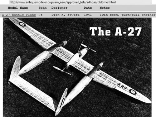

Back then, there were still other unknown push-pull twin-boomers. This A-27 though seems a what-if dream of those times, not a model copying the true North American A-27 (aspect unknown to me):
from http://www.antiquemodeler.org/sam_new/approved_lists/adl-gas/oldtimer.html
Well, the true A-27 was a T-6 derivative, less interesting than this push-pull oddity...
see http://en.wikipedia.org/wiki/North_American_A-27
