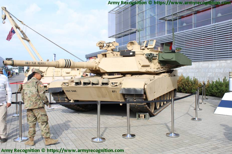

The Trophy APS is a situational awareness and Active Protection Hard Kill (HK) System that is available in three main configurations: HV (Heavy armored Vehicle), MV (Medium and Light Armored Vehicle) and LV (Light Armored Vehicle). Both configurations dramatically boost the force’s survivability and provide a vital add-on capability for the maneuvering combat teams.
Trophy-HV protects heavy (>30 ton) and medium weight (>15 ton) armored vehicles from a wide variety of threats ranging from rockets, ATGMs (Anti-Tank Guided Missiles) and platform-fired High-Explosive Anti-Tank (HEAT) rounds. Trophy-HV offers 360° protection in azimuth, as well as extensive elevation coverage, while maintaining a pre-defined safety zone for friendly troops on the ground. The neutralization process is initiated only if the threat is about to hit the vehicle.
Army Recognition Global Defense and Security news
Rafael Trophy APS active protection system fitted on an M1A2 Abrams main battle tank (Picture source: Rafael)

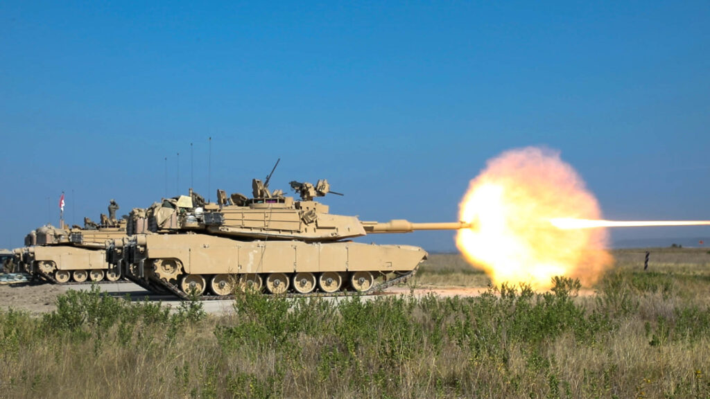

You won't really see much given SEP v4 adds:
  • An upgraded Gunner's Primary Sight (GPS) with a third-generation forward-looking infrared (FLIR) sensor, improved laser range-finder, and full-color video camera.
  • An upgraded Commander's Primary Sight (CPS) with a third-generation FLIR and full-color video camera, as well as a laser pointer and range finder.
  • Lethality improvements including the addition of a digital data link that can communicate with the Army's new reprogrammable XM1147 Advanced Multi-Purpose (AMP) round for the tank's 120mm main gun.
  • A new onboard meteorological sensor that can collect various types of data to improve accuracy.
  • Upgraded communications, data-sharing, and onboard diagnostics systems.

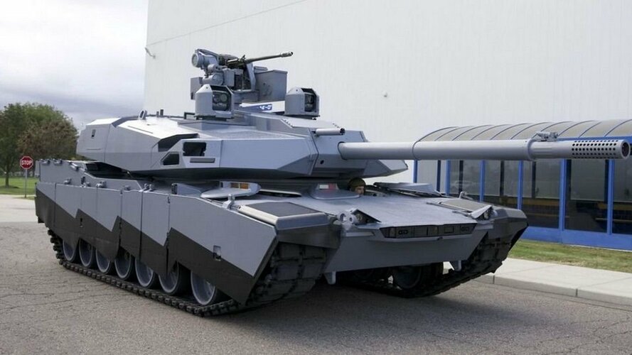

They are redefining their requirements for what they are calling “M1E3” after the cancellation of the SEP4 upgrade. M-1X was an industry demonstration, not something government sponsored. However I suspect that any future tank would have most of the M-1X features…though it has basically nothing in common with the M-1.
As far as I could understand from the photo:
the body, chassis, and possibly the power plant have moved almost unchanged from the M1. Naturally with a new body kit. The fuel tanks were removed in the control department and a separate capsule was made for the crew according to the type of T-14 tank. However, it is not very clear how comfortable it will be to be located there in a lying position. The T-14 crew capsule has a high ceiling, a toilet and cooking tiles.
Turret X is new and naturally uninhabited. It's clear here.
The gun is apparently new, but of the same caliber 120 mm.

My understanding is that this vehicle reduces crew from 4 to 3 and moves them into the forward hull - see the three hatches on the front of the vehicle. I believe it also uses hybrid diesel/electric propulsion, not a turbine. The turret is heavily redesigned with no crew and autoloader, and a different 120mm gun than the current Abrams (see muzzle break). So I think this vehicle has only external similarities to the M1; engine, hull, turret are all radically different (and gun is similar but not the same). I think labeling it part of the M1 series is misleading, but presumably that is a marketing ploy.
And why the armored side screen have such an uneven shape with ledges? Does this make any sense or is it just a design element?
It's about as much an Abrams as the old TTB. Hull is Abrams, internal arrangement is significantly different.
I'm thinking how can a hybrid powerplant be adapted to a tank? It's not a car. Car in the city yes - acceleration / braking, acceleration /braking. Braking by recuperation charges the battery. But the tanks have a different mode of movement. The tank usually either stands still or moves slowly. And as soon as he removed his foot from the accelerator pedal, tank immediately stopped under itself weight. It is almost not necessary to turn on the brake. So the battery will not be charged. It is easier to make an energy accumulator from a cannon. So that the battery is charged with the energy of each shot.
