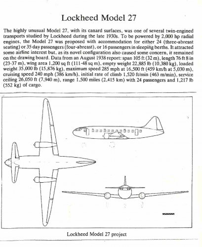

Source: Bill Slayton article in Dirty Plastic newsletter Issue140, IPMS Phoenix

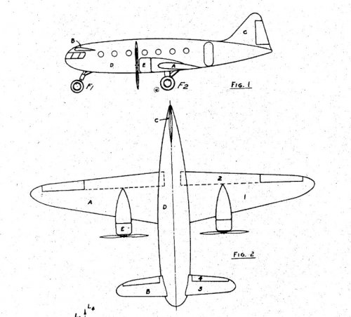

here is a Lockheed patent for canard airliner aircraft.
http://archive.aviationweek.com/image/spread/19451126/14/2/zoom

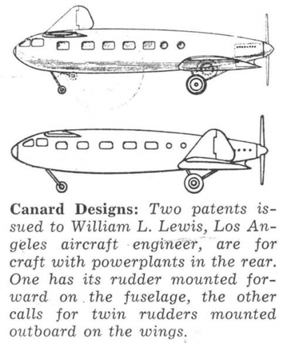

hi
I don't remember where I've found this, but
it's a third model of this plane, look at the find
No, that is not a Lockheed patent, Lewis was a freelance aeronautical engineer who had worked for several aircraft companies but not Lockheed. Its all in the article you quote
toura said:
hi

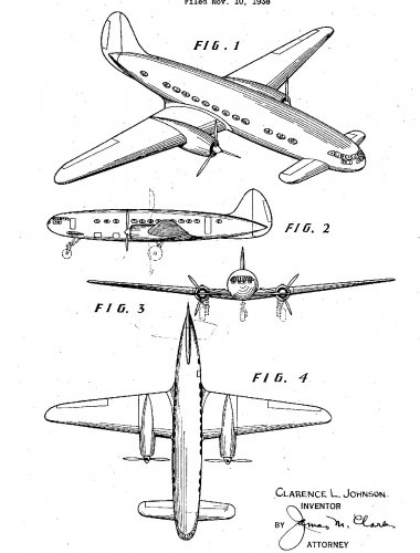

Yes, that is based on Lockheed/Johnson patent US2271226 submitted in 1938 and granted in 1942
Here are the two Lockheed patent designs, both from 1938
