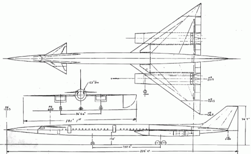

Not 480, it's CL-408, more precisely CL-408-15. That iteration was the heaviest, GTOW at 257.200 lbs. Passenger max 124, cruise speed Mach 3 and circa 70.000 feet. Sorry, no internal arrangement.

sad, but with 123 inch ø = 3,1242 Meter ø would be like this: 3 seat - small corridor - 2 Seat ?
AFAIK, the first SST projects requested by the Air Force as a dual (civil and military) trisonic multipurpose aircrafts were meant as trancontinental ranged (2000 miles). Yep, five abreast would make sense. And, BTW, the 3views and the art aren't of the same aircraft, probably different 408 iterations.
There's a marked difference between the color illustration and
the 3-view shown us...
Probably two different designs ?
Yes, Paul, two different iterations of the 408 model number
