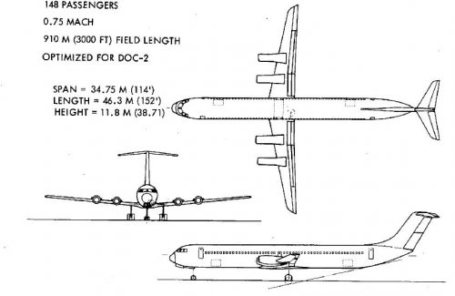

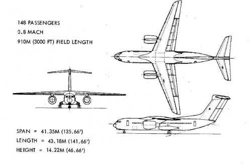

Three-view drawing (top) of 910 m (3000 ft) OTW-IBF vehicle.
Three-view drawing (second) of 910 m (3000 ft) OTW-IBF vehicle optimized for DOC2.

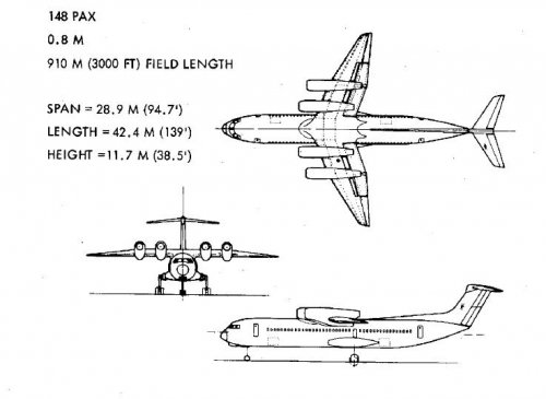

Three-view drawing (three) of 910 m (3000 ft) AW vehicle optimized for DOC1.

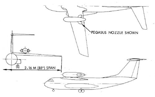

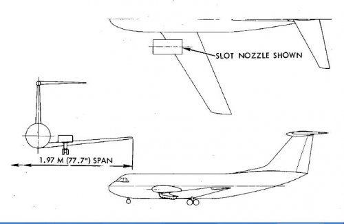

Additional concepts from Renshaw, J. H.; et al. Evaluation of Advanced Lift Concepts and Fuel Conservative Short-Haul Aircraft, Volume 1 :

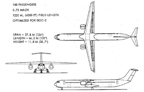

Three-view drawing (top) of MF general arrangement, FPR 1.35.
Three-view drawing (second) of 1220 m (4000 ft) MF vehicle DOC 2.
Three-view drawing (third) of Lockheed powered lift model (high wing)
Three-view drawing (fourth) of Lockheed powered lift model (low wing)
