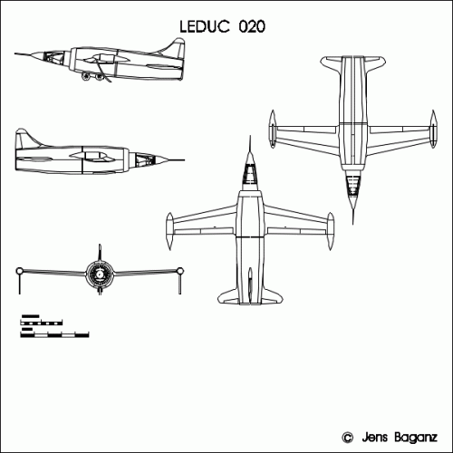

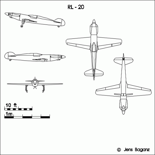

As you are mentioning the "RL" types , I think, you've made the same mistake,
than me some years ago : There were TWO Rene Leducs, one, the better known,
the designer of the ramjet powered types, the other, born at St. Père-on-Retz,
designed light aircraft.
Here are the Leduc 20 and the RL-20 designed by the "second" Rene Leduc.
The differences aer clearly visible ....
Good source for both is Docavia "René Leduc - Pionnier de la propulsion à réaction"

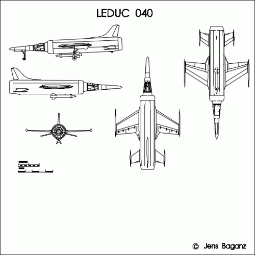

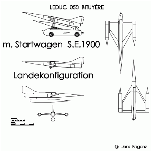

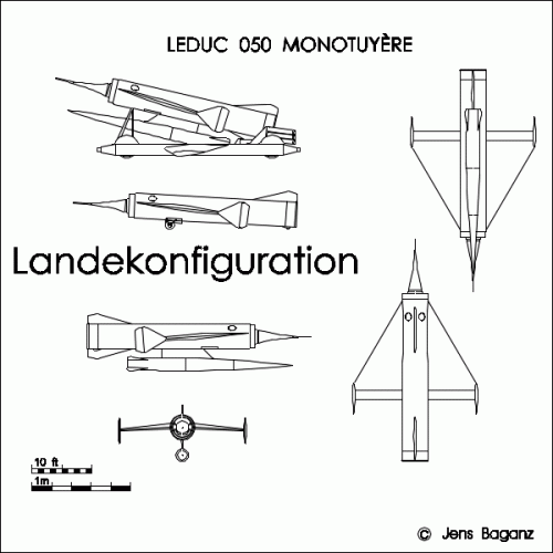

The Leduc 40 was planned as an operational variant, very similar
to the Leduc 22.
The Leduc 50 designs were envisaged as manned or unmanned
bomber and reconnaissance aircraft, which should take-off with
the help of rocket powered chariots. Single and twin engined
variants were designed, SNCASE and SNCAC designed two
chariots.

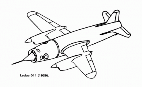

Great thanks to you my dear Jemiba,
It's amazing answer from you my dear,and sorry for RL-11, I wrote it wrong
and the right is 011 research aircraft,do you know it ?.
The Leduc 011 was a proposal for an operational version of the
Leduc 010, as a mixed propulsion fighter/interceptor. It would
have been more or less the same fuselage as the 010, with a
wing with straight leading edge and two piston engines, either
Regnier 6G or Bearn , and 1 or two 20mm guns, carried in the
wing root. Crew would have consisted of two.
(Drawing from the above mentioned Docavia)

- Leduc 020, enlarged version of the 010/016, which led to the
- Leduc 021, two aircraft built.

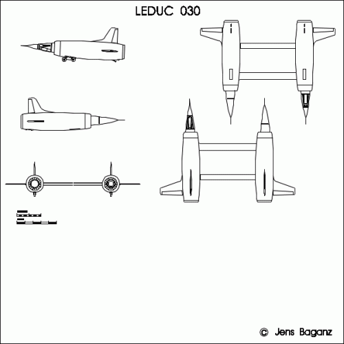

- Leduc 030, project for a twin fuselage supersonic interceptor,
with a central wing
