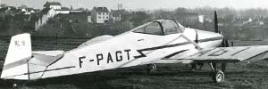

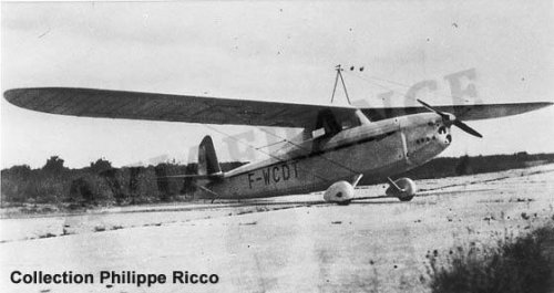

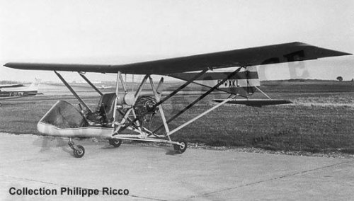

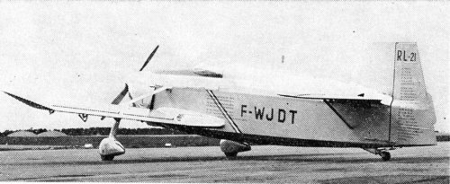

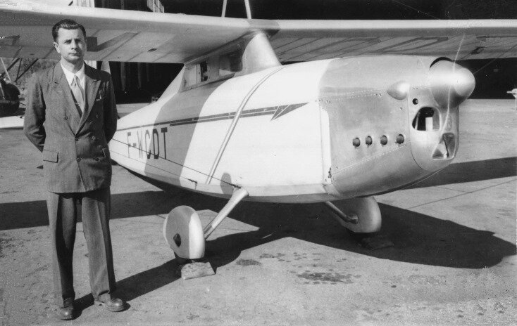

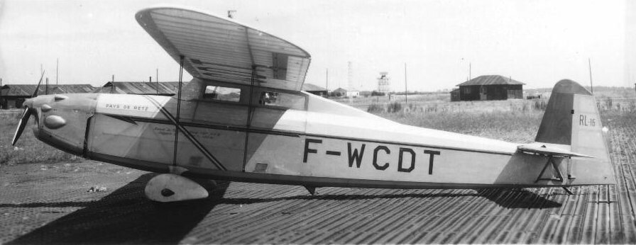

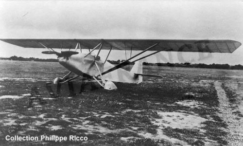

In regards to René Leduc from the Aviafrance website, I have the following models listed:
RL-12 - A single seat touring parasol format monoplane, which first flew 2/7/1939 and of which only one example was built.
RL-16 - Also a single seat parasol monoplane, but this model was used to achieve a class altitude level of 7788 metres on the 13th June 1949. The RL-16 had first flown on the 7th July 1947.
RL-19 - This was a two-seat side-by-side configuration, low wing monoplane for touring. First flight was on the 23rd June 1952. One example built.
RL-21 - Another record breaking aircraft the RL-21 flown by Raymond Davy broke the speed record for its class of low powered aircraft with a speed of 316 km/h on 13th October 1960. This record was increased to 334 km/h on the 12th July 1963, and further increased to 350 on the 21st December 1966. Like the RL-16, it featured wooden construction wings with a fuselage combining wood and metal materials.
RL-24 - Making its maiden flight in November 1975, the RL-24 was an ultra-Light aircraft. It was a single-seat with a parasol wing configuration and a pusher engine. Like the other RL designs just one example of the RL-24 was built.
I attach pictures of the aircraft with some from Avia france and others from alternative web sources..

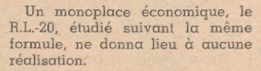

From Ailes 16/4/1955,
here is a small Info about RL-20 Project.

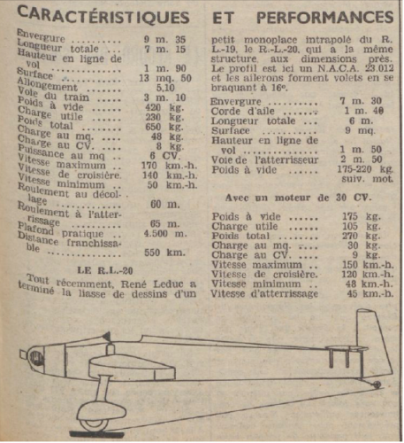

Also from Ailes 5/11/1960,
the RL-20.
