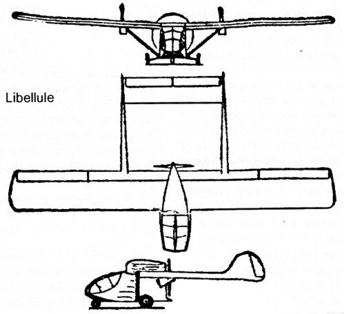

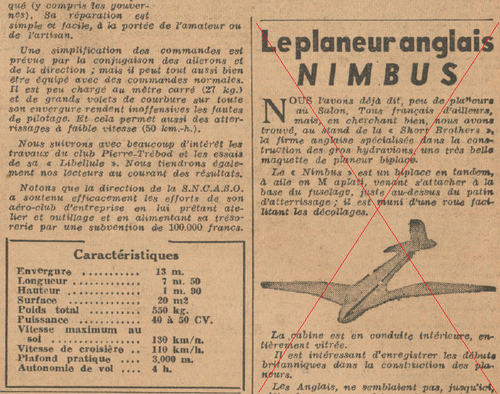

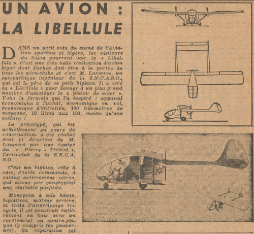

In the Trait d'Union #244 (March-April 2009) is presented the Lasserre Libellule (dragonfly), revealed in "L'Aviation Française" of 1946. M. Lasserre was engineer at the SNCASO ('Sud-Ouest') company and wanted to create a fuel efficient airplane. It was being built in 1946 by the Pierre Trébod air-club but never finished it seems. Side by side two-seater with double commands. All in wood. Landing speed as low as 50km/h. Span 13m, Length 7.5m, Height 1.9m, Total weight 550kg, Max speed 130km/h."

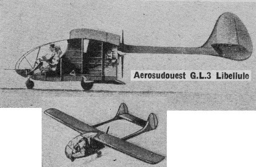

Yes: in The Aeroplane Spotter Vol. VII No. 177 I found confirmation.
The reason of the twin-boom layout seems good visibility and easy access with a pusher propeller, like in many pre-war projects and prototypes.

Maybe. The type of engine is not mentionned. It is only explained that the goal was 10 liters of fuel for 100 kilometers at 100km/h (almost like a car of that time I think), a 4-hour flight should have been possible.

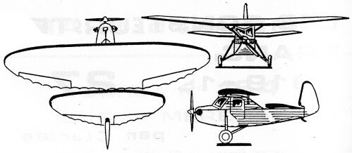

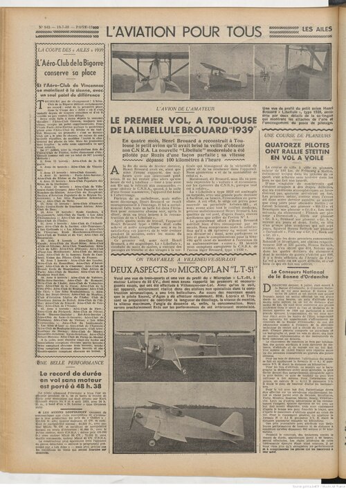

The name "Libellule" was also used for a French aircraft designed "after-hours" by an engineer of a public company: Henri Brouard of SNCAM in 1937. It had tandem wings but was not of the "Pou du Ciel" principle, simply with classical controls.
(Source: Trait d'Union #164, Nov-Dec 1995)
From Ailes.
