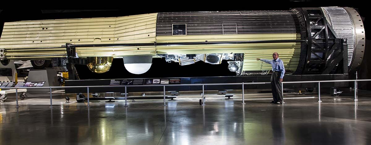

ON THIS DAY, in 1971, the first Martin-Marietta Titan III-D space booster launched from Vandenberg Air Force Base, California. It was a two-stage liquid-fueled, core vehicle with two additional outboard strap-on thrust pods of solid propellant.
Titan IIID was flown 22 times with KH-9 and KH-11 reconnaissance satellites between 1971 and 1982, all successful launches. It was designed for heavy low Earth orbit payloads.
It was retired from service in 1982, and replaced by the upgraded Titan 34D. All launches occurred from Space Launch Complex 4E at Vandenberg Air Force Base.
