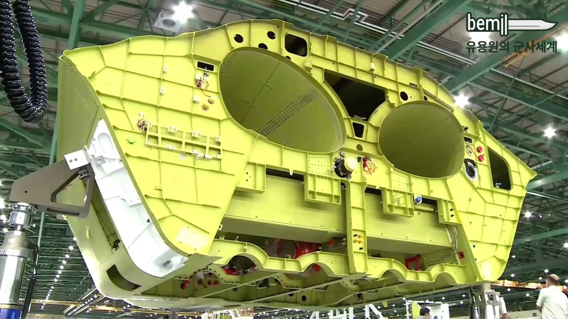

They'll be small missiles though. I thought we previously got that the bay was designed around either 2 x AMRAAM or 4xSDB. There's pretty clearly not space for 3 x AMRAAMs per bay to me.
Well if it's 2 amraams+4 sdb that wouldn't be far off the f-22 would it?
The bay pics are already out in the open
note that there is a semi recessed area on the bottom, but this can be removed and the entire bay. utilized.
but the bottom panel gives you scale as they are shaped for AMRAAM/Meteor

Even the F-35 A/C is supposed to accept 3 per bay in the future (aka sidekick).
Significantly? Boramae isn't a small aircraft either. Actually it is a bit longer than F-35A.
Based on this, yeah, it seems quite a bit longer than the F-35
which is 15.6 x 4.36 x 10.7
We don't know yet how the IWB will finally look like. IF it is long enough missiles could be offset longitudinal and IF it is deep enough a vertical offset may be possible as well. It appears there is plenty of volume available below the intake ducts. It's rather a matter of how much fuel one is willing to trade for ordnance.
Ah, i suppose that i mostly had fuselage cross section in my mind
I imagine the AMRAAMs will be longitudinally offset in the bay
I would given the image shown above by helmutkohl - it just isn't possible without some serious redesign.
Even if you chop the fins off and don't want to launch them, I fail to see how 3 per bay would fit.
Seems to me to be the opposite, you couldn't fit three meteors, but if you can off set the third missile in the middle forward by a few inches, three amraams should be possible if a little tight.

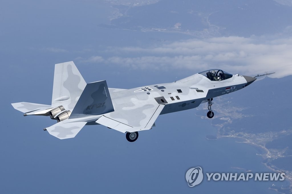

Also, 5th prototype flew. They'll be on full six bird test fleet very soon.
this one has a unique color scheme compared to the others
is this the one that will be sent to Indonesia?

From my eyes, KFX/IFX looks so much more serious than TFX. I really like TFX/IFX aircraft.

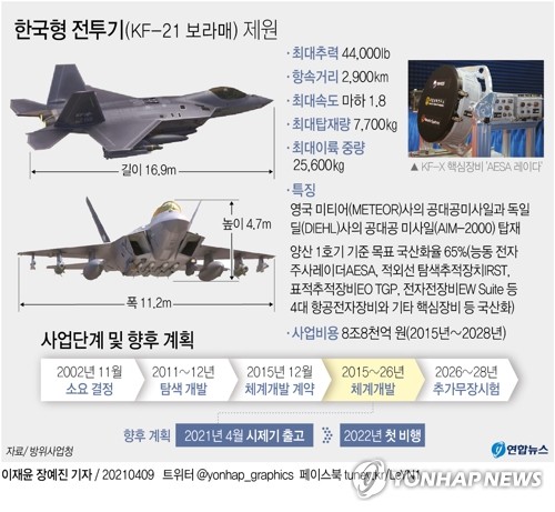

Yup, 003 and 005 are a bit different in terms of their camo. The last time I've posted the infographics it was a bit lowres so here's a better one :
If you ask me I prefer the camo schemes of 003 and 005. 005 especially looks way better under real lighting conditions on an actual aircraft, compared to the graphic.
Yes, the 005 is the one that is supposed to be sent to Indonesia but we'll see how that turns out. Their government now seems a bit more serious about getting their shit together and back on track since the thing flew. I've heard that they've recently also sent a plan about the detailed schedules of the resumption of their payment including a transaction plan for the arrears, though I'll only trust what they're saying once those arrears are actually resolved; so is also the apporach by the Korean government and I'm glad they're not playing soft here. Also, Poland touting their interest on more cooperation with the Koreans, including a potential involvement in block-2 and a co-development of block-3, is acting as a sort of a wake-up call which I find very beneficial to the program.
