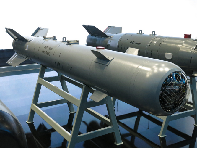

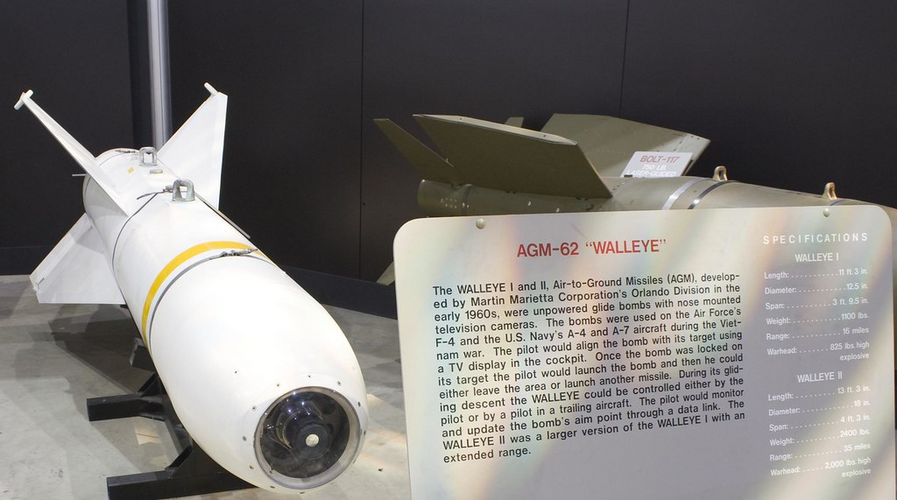

Hello I have a question. Can the KAB-500Kr bomb track moving targets like the American WALLEYE ?
If so, what is the evidence for this ?
Warthunder notwithstanding, Walleye wasn't really used against moving targets. It needed a stable, high-contrast scene to lock on reliably, and small moving targets were far from ideal.

One example:
THE DEVELOPMENT OF PRECISION GUIDE BOMBS: THE LONG ROAD TO DESERT STORM AND BEYOND
You'll note that the typical targets for Walleye were bridges, barracks, and bunkers. Other sources also mention power plants and other fixed targets. No account I can find mentions Walleye engaging moving targets on land. (Paveway LGBs were used on moving targets.)
The one obvious exception is that Walleye was also intended to target ships at sea, which are moving, but also usually offer good contrast and not much clutter to deal with.

Thank you. Do you have more sources?

Sorry, that's the limit of the research I'm doing. And I'm not aare of Kab-500Kr at all -- just wanted to correct the misconception about Walleye.

Ok. If u have more sources about walleye and other bombs like gbu-8,gbu-15 without thermal seeker couldnt track moving targets please post here sources etc..
No, 500Kr (or any TV-guided KAB) can't track moving target, since it uses whole picture correlation.
