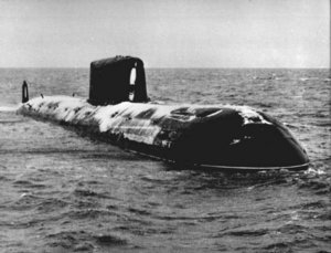

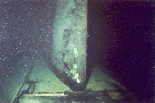

All right,
Then
Now
why was another one not built?
flawed design?
soviet collapse?
Just call me Ray
Aug 26, 2007
674
15
Two reasons:
1.) It sunk. Given the technical sophistication of submarines, I imagine one would be hesitant to reproduce a design in which the only example sank (i.e., the assumption that it was flawed).
2.) It had a liquid-metal reactor, a design the Soviets experimented heavily with but gave them a lot of trouble (see the Alpha-class, which also used liquid-metal reactors. I believe one of them sank as well).
Antonio
Jan 22, 2006
3,552
360
K-278 was an advanced combat submarine (primarily a development ship but fully combat capable) to evaluate new technologies for 4th Generation Soviet SSN: titanium hulls, 1000 m depth, max speed in excess of 30 knots, advanced sonar, highly automated...Propulsion was provided by a single OK-650b-3 reactor.
Design started by late 60's leaded by N.A. Klimov and, after his dead in 1977, Yu. N. Kormilitsin. K-278 entered service in 1984.
Several times the management of the Rubin design bureau proposed building additional Project 685 submarines but that proposals were not accepted. Northern Fleet command was in favor of additional units said deputy chief designer D.A. Romanov. The accident cancelled any possibility for a series production.
