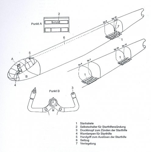

From EF 131 Bedienvorschift,Bericht Nr.S-317,August 1946. Post-1

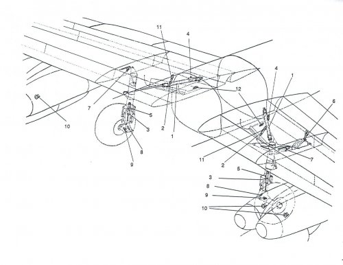

From EF 131 Bedienvorschift,Bericht Nr.S-317,August 1946. Post-2

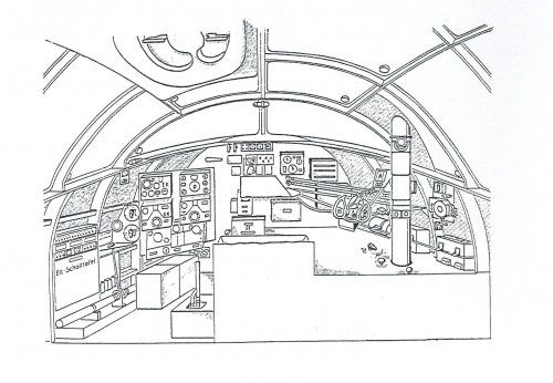

From EF 131 Bedienvorschift,Bericht Nr.S-317,August 1946. Post-4

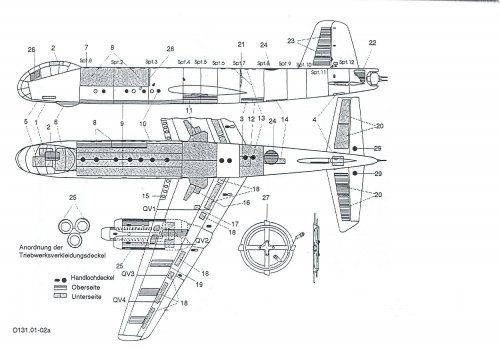

From EF 131 Bedienvorschift,Bericht Nr.S-317,August 1946. Post-5

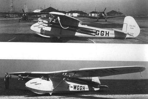

Does anybody know if it was ever test flown with the 6 engines in clusters of 3? I can't find any photo of it, only with 2 engines (1 each wing)
I have this photo on my disk, with a note saying 4 Escopettes. But to me it looks more like 6:
Arsenal SA-104 Emouchet glider with SNECMA Escopette pulsejets tested in 1950.jpg

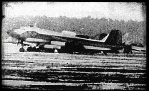

This is not the EF 131. I've attached this pic of the EF 131 while parked at the airfield in Ramenskoye in the winter of 1947, with two Lisunov Li-2s in the background.
