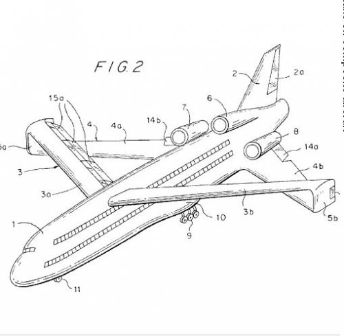

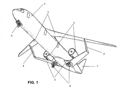

a project for ring wing double deck airliner.
http://www.flightglobal.com/PDFArchive/View/2003/2003%20-%200326.html

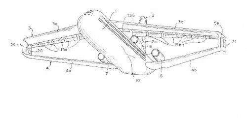

box-wing aircraft.

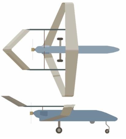

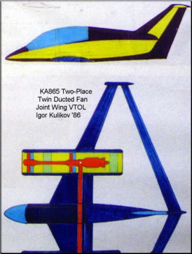

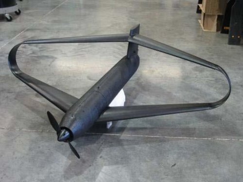

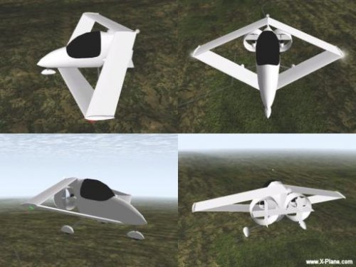

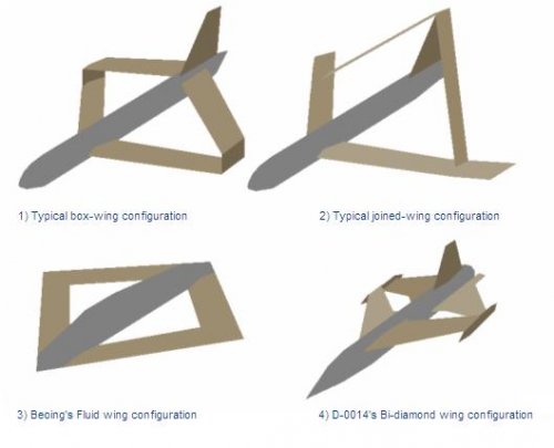

Here's what I believed to be a CG concept drawing for a joined-wing glider. Picked this up from a foreign language forum which was using this to explain the joined-wing concept. There was no reference to this glider design perhaps members in know can assist.

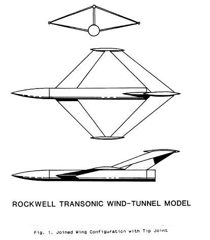

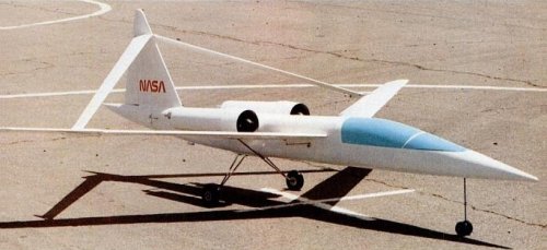

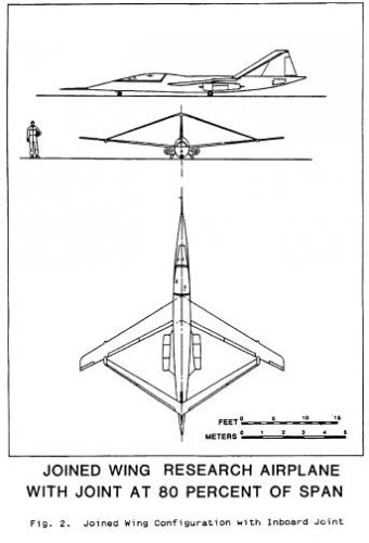

http://ntrs.nasa.gov/archive/nasa/casi.ntrs.nasa.gov/19900005777_1990005777.pdf

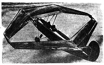

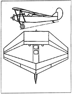

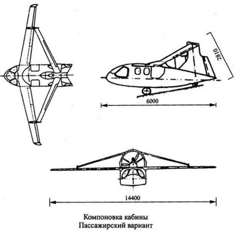

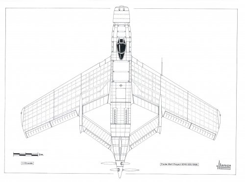

Something more retro: The MAI-Kuzakov modified Po-2.
A scale model was wind-tested in 1951 by the Moscow Aviation Institute.
Photo and drawing from "Letatyelnyye Apparaty MAI" by Makarov, 1994

This one was also designed and tested by the MAI, but I don't know the specifications and history.
Is there a 3V drawing available?
Photo from "Letatyelnyye Apparaty MAI" by Makarov, 1994

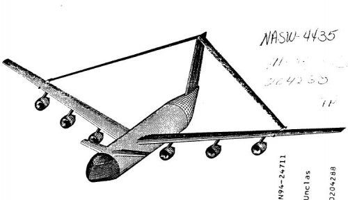

Also California Univ. joined-wing very large transport aircraft,it look
like Lockheed C-5 fuselage.
http://ntrs.nasa.gov/archive/nasa/casi.ntrs.nasa.gov/19940020238_1994020238.pdf

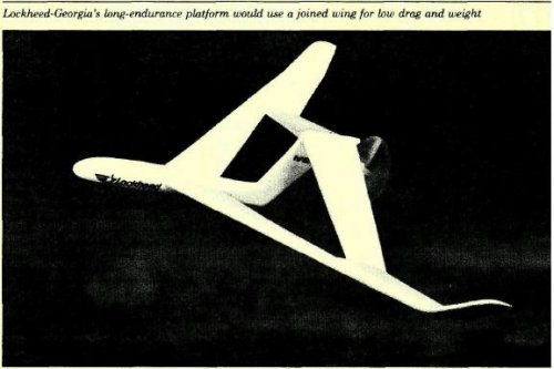

From Lockheed Georgia,the Joined-wing long-endurance RPV.
http://www.flightglobal.com/pdfarchive/view/1987/1987%20-%200018.html

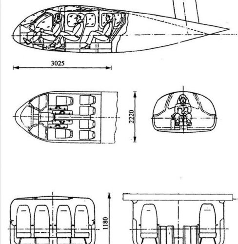

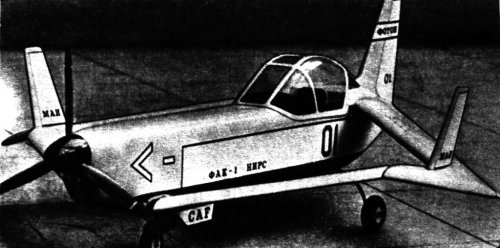

1976 V. Kuznetsov drafted sport aerobatic aircraft "Photon-01" diamond-shaped wing. The aircraft is now intended to establish a piston engine M-337 260 hp with a tractor propeller.

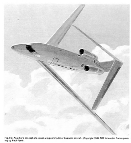

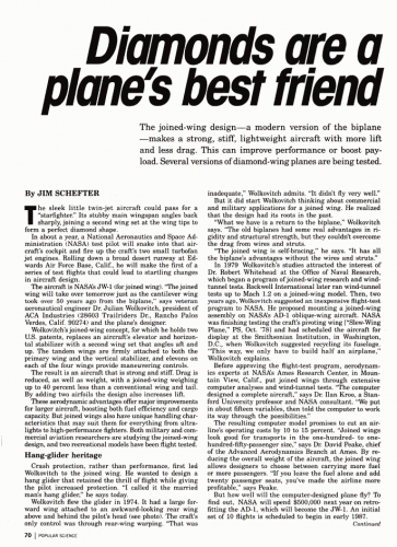

John Wolkowitch's ACA Industries JW-1 and derivative projects:
index.php

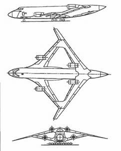

In 1977, Mr. Kuznetsov was designed to Moscow Aviation Institute super-heavy transport aircraft with diamond-shaped wing.

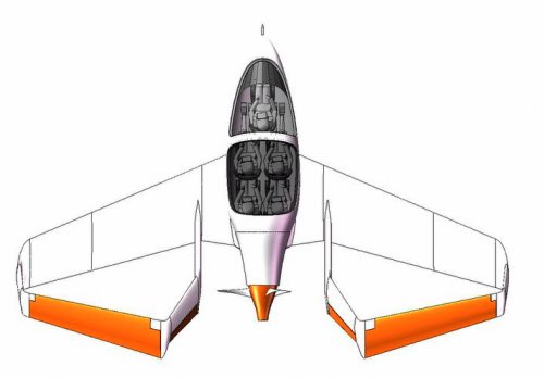

The Green Flight Challenge will be held September 25 – October 1, 2011 at the Charles M. Schulz Sonoma County Airport in California. Nine teams are registered to compete in the competition. Team Synergy is led by John W. McGinnis. They are located in Montana. Their aircraft is a clean sheet design, featuring laminar flow, wake-immersed propulsion, open thermodynamics, subsonic area ruling, composite construction, and five seats. Synergy is currently registered and has met the FAA inspection.
Seats: 6
Max. power: 142 kW
Span: 32.0 ft
Energy type: Bio-diesel
Sources:
- http://www.synergyaircraft.com/
- Synergy: A Practical Lightplane for the New Century
- Proyecto Synergy, Buscando La Máxima Eficiencia
- NASA Green Flight Challenge: Conceptual Design Approaches and Technologies to Enable 200 Passenger Miles per Gallon
- Synergy on Facebook (access to many other pics)

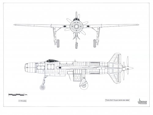

Phew ! I had to go google the FW oddity.Despite looking like a turbo-prop, it is piston-engined, via an extension shaft...
Box wing or not, the wing surface is so ridiculous that I can't see that thing staying up in the air for a minute...
It doesn't look like there's enough wing area to produce sufficient lift to get that thing off of the ground. Though a simple solution would of course just be to increase the takeoff speed. ;D

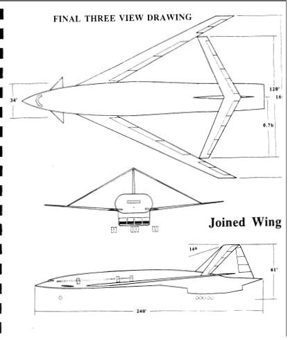

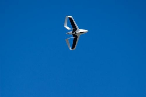

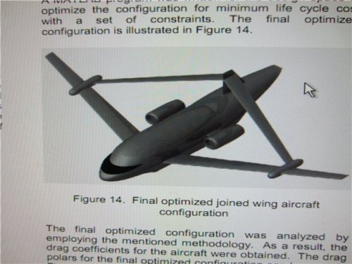

Hi;

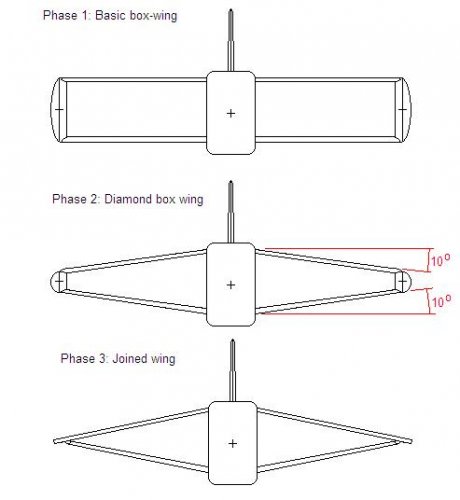

the Final optimized joined-wing aircraft configuration.

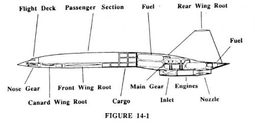

Can anyone summarise the advantages of these wings. Being joined do they have greater structural strength. The all seem much thinner then conventional wings - would that mean less room for fuel storage? Regards
In short: you have two wings of higher aspect ratio, and short chord. That might help some with achieving laminar flow (although the required sweep does not!).
The biggest plus is the fact that the wings are braced, so for a given strength they can be made lighter or with higher span. Both the high aspect ratio and the three-dimensional profile of the wing (seen from the front) help with induced drag.
