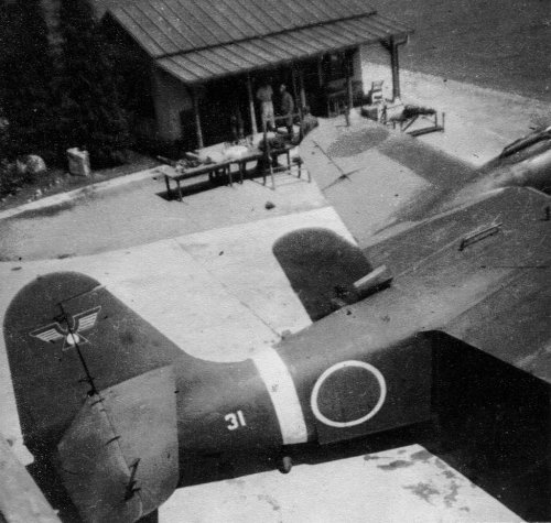

Hi Folks
In expanding and updating Skyblazer’s list shown above (reply #1), I’ve been researching the details of the many foreign aircraft purchased and evaluated by the IJN before the Pacific War.
The Grumman G21(A) Goose is mentioned in many references as having been purchased by the IJN in the late 1930’s and subsequently evaluated as the “LXG Type G Amphibious Transport”. After a lot of digging, I can find no evidence that such purchase ever happened. The Grumman G21 construction numbers are well-documented in Francillon’s “Grumman Aircraft Since 1929” and on Geoff Goodall’s extremely thorough site at:
http://www.goodall.com.au/grumman-amphibians/grummangoose.pdf
No mention of a sale to the IJN appears in either. The only photos extant of a Goose in Pacific War Japanese markings are of a Dutch example captured by the IJA in the Netherlands East Indies in 1942. The Tachikawa triangle-motif tail markings on that machine show that it was evaluated by the IJA.
Has anyone seen evidence that a G21 was in fact purchased and evaluated by the IJN prior to WW2?
Best Regards, Harry

Hi Hesham
Thanks for your attention. I have seen this particular website ( and many others) in which this assertion concerning an IJN G21 is made. All contain flat statements without evidence or sources. I'm fussing about this because the two sources I referenced above list the entire G21 production by construction number. This one:
goes on to list the fate of nearly all of these aircraft as well; including, importantly, the fate of ALL examples built before 1940. The alleged IJN order remains unaccounted for.
All of the other aircraft on Skyblazer's list can be supported by c/n, contemporary records, etc. On this one, silence...
I'd be thrilled if we could find otherwise.
Best, Harry
