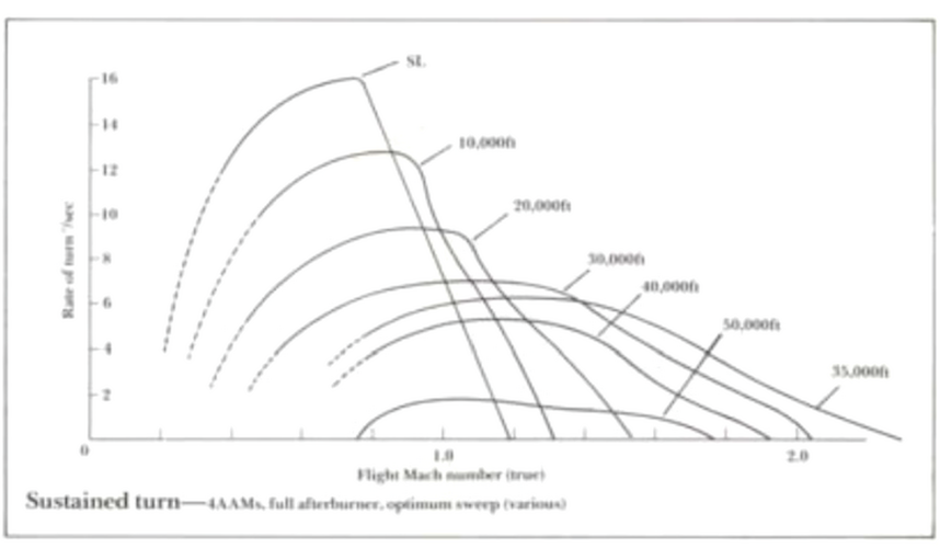

I have the same question! It would be really nice to get hands on the aerodynamic charts. I read Markovsky's book, apparently the MiG-23MLD had an overwhelming advantage in maneuverability over the MiG-23ML.
